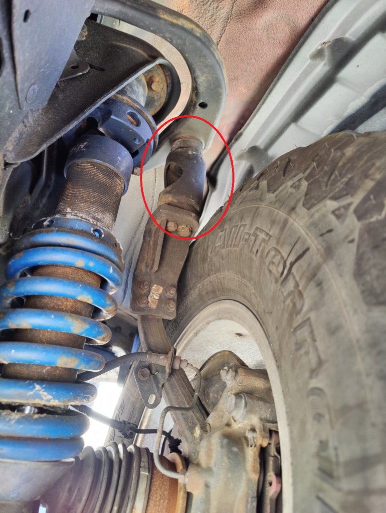

    On the Tuff Country 4.5" lift kit specifically, yes, there is a spacer that goes on top of the factory spindle in order to fill the gap between the knuckle and control arms. It's either this thing I'm circling, or the weird contraption that's bolted to the top of the factory knuckle/spindle below. I believe this may be it, or it's something similar to this.
    I know @Hi06silver went out of his way to unbugger up his Tuff Country lift. There's only so much you can do to reverse it, it requires permanent cutting of crossmembers and such, it's a pretty extensive bracket style lift.

    FIFY! Tis that thing you circled and this also the evil bracket below the death spacer.
    Spindles came preloaded with Koyo bearings. Depending on wether or not you have abs spindles are different, obviously for the sensor. That's a whole nutha' issue unless they fixed it. I'll drop a link to my original thread if you have any questions just reach out OP. Someone helped me I'm more than willin to help the next person. I'd suggest reaching out to the vendors @shifty` mentioned because the spindles were not cheap when I bought them a few years back.
