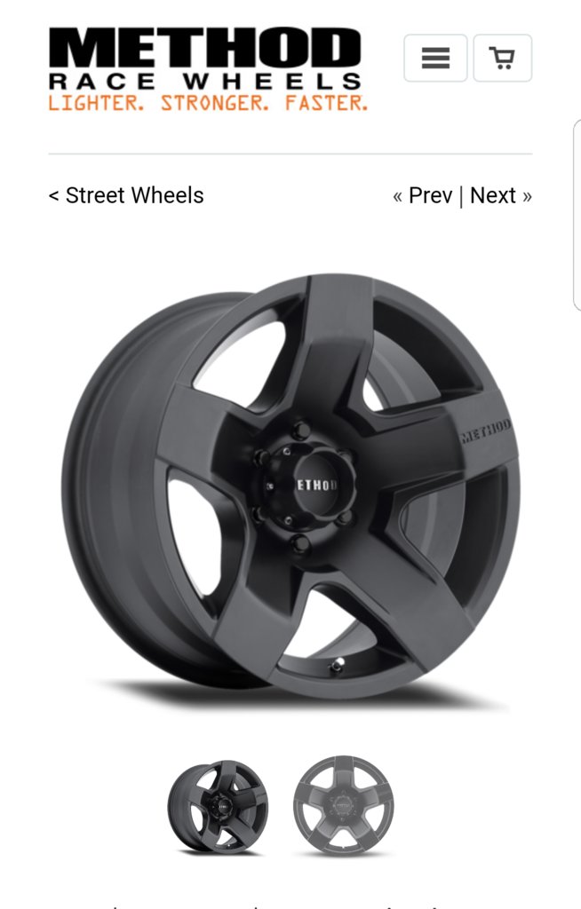

    Wondering if you guys can point me in the right direction. I am in search of the right wheels to put on the truck. Here is what I have in mind:
    18"
    Black (no accents, stainless, or polished bits)
    Simple
    5 or 6 spoke
    I like the Method Fat five, but I can only find them in 17". I've looked at Fuel wheels and Moto Metal wheels, but didnt find anything I liked.

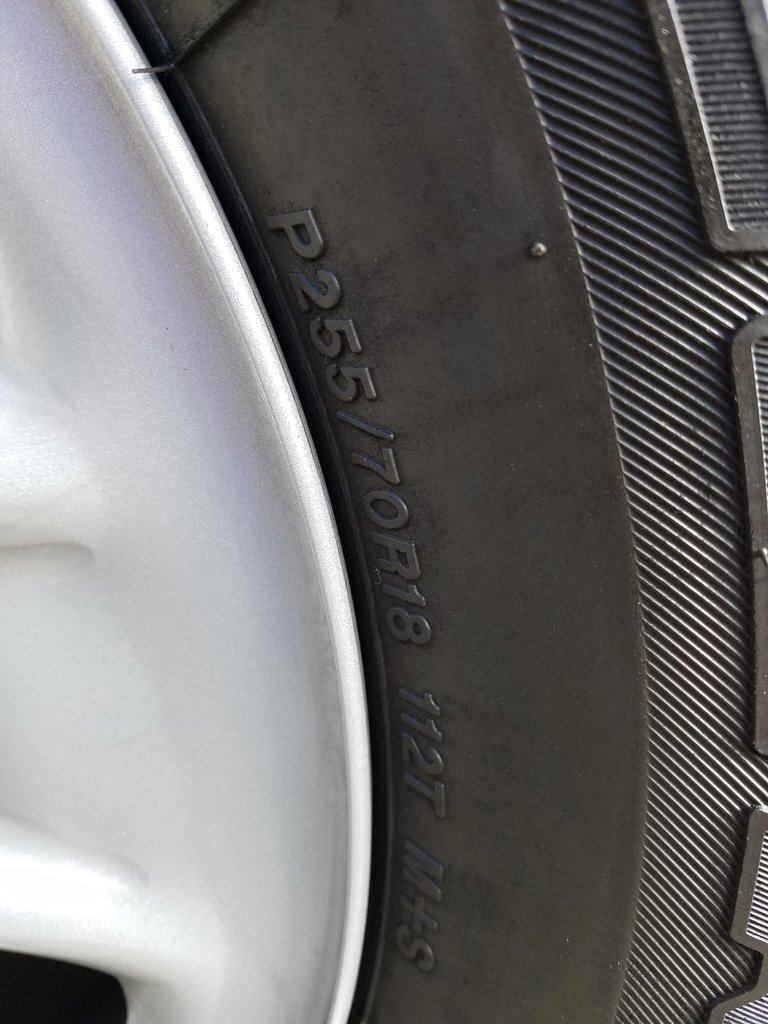

    So I am going to go with the Black Rhino York in Black.
    Part # 1890YRK125150M10 They are 18x9, Front and Rear, 5x150, with +12 offset.
    My question is now, just to verify. I am not buying new tires until I wear these Michelins down a bit. I still drive 100 miles a day to work, so 35's aren't screaming MPG. My stock P255/70R18 should fit these wheels no problem right?

    I think those are only approved for a max of 8.5 width rim. I believe FN wheels are being suggested since you mentioned gas mileage. Those FN BFDs only weight like 20-22lbs.

    So, essentially no. My stock tires wont fit/be rated for the new 9' wide wheel. Damn

    Correct, I would follow those specs by the tire manufacturer. Possibly look for an 8” wide wheel if you really want to those run 255 width.
    You probably could do it and have it stretched. I see Honda civics and such like that. But I personally wouldn’t try it with a big half ton truck that is heavy.

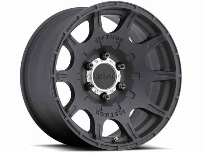

    Mid travel fox 2.5 coilovers 2.0 real shocks shims 295 70 18 trail grapplers pro accessories 32in light bar blacked out bed cover sway bar Moto metal 970 18x9
    Method ftw

    Method roost in aure u can get a black hub cap.
