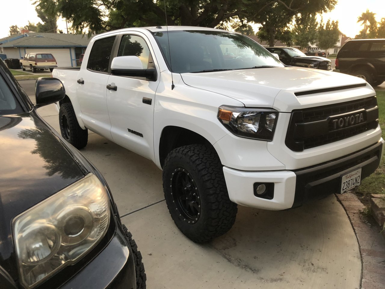

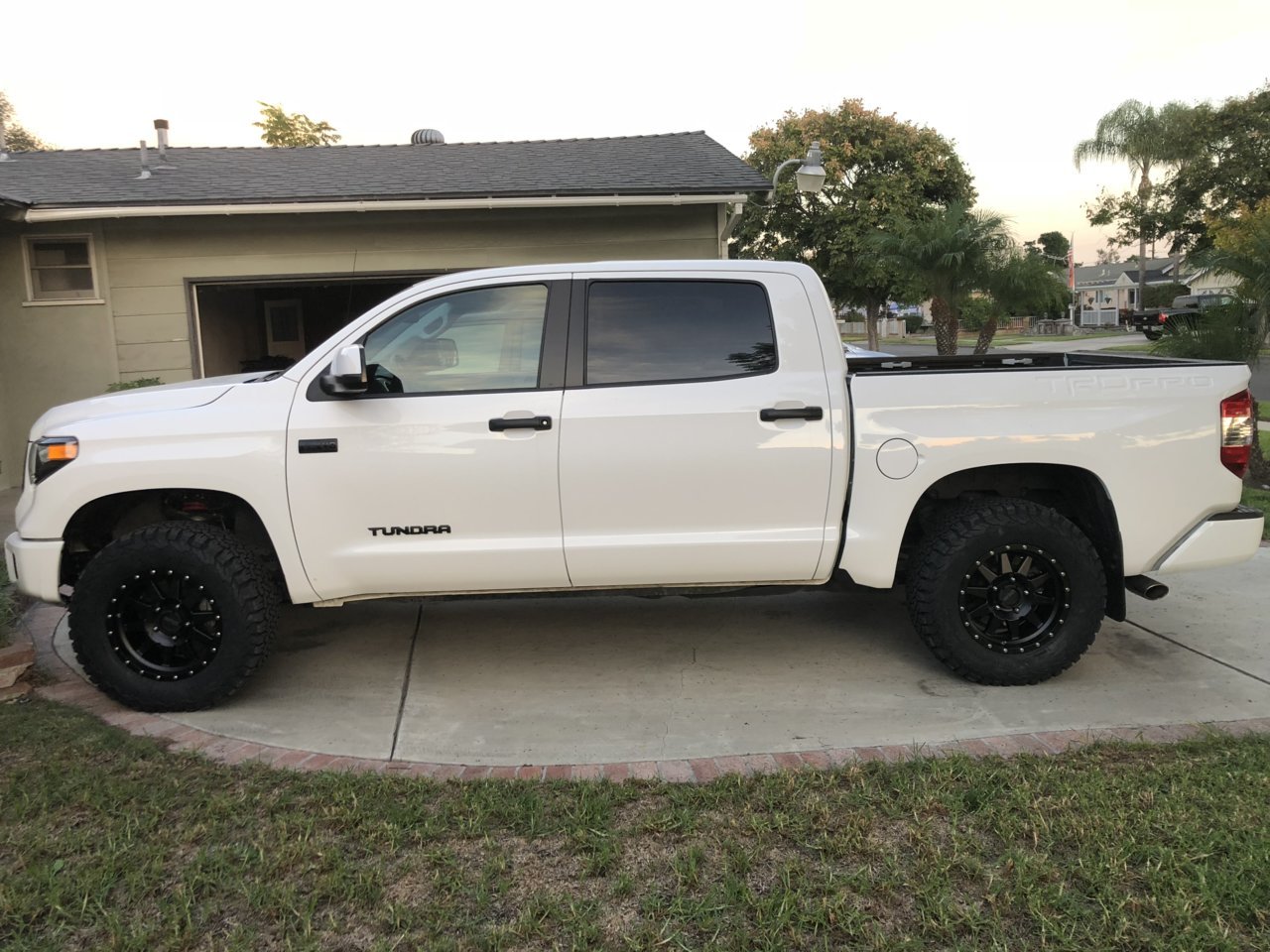

    Just got the Tundra done yesterday. Super happy. Thanks for all your help!
    Here is what I got, 305/65/18 BFG KO2’s and Method “The Standard” rims 18/9.
    Front fender liner needed to be removed does anyone have a work around for this? 54B477E8-092B-46AE-A686-823423854670.jpgBA2BA9E4-5CB2-44AB-A1D0-C99BF9DA494E.jpg

    Looks awesome Mike! Regarding the Front Liner, you can always shave the bottom with a dremmel tool and also use a heat gun to push the plastic inwards. Here is a great video on using the heat gun for pushing the liner forward:

    https://youtu.be/HMgKGBNghn0
    Here is the video I found to maybe give you an idea. It’s not completely detailed like I would want it to be, but hopefully gives you the gist of it.

    Thanks guys, super helpful. I’ll get this done.
