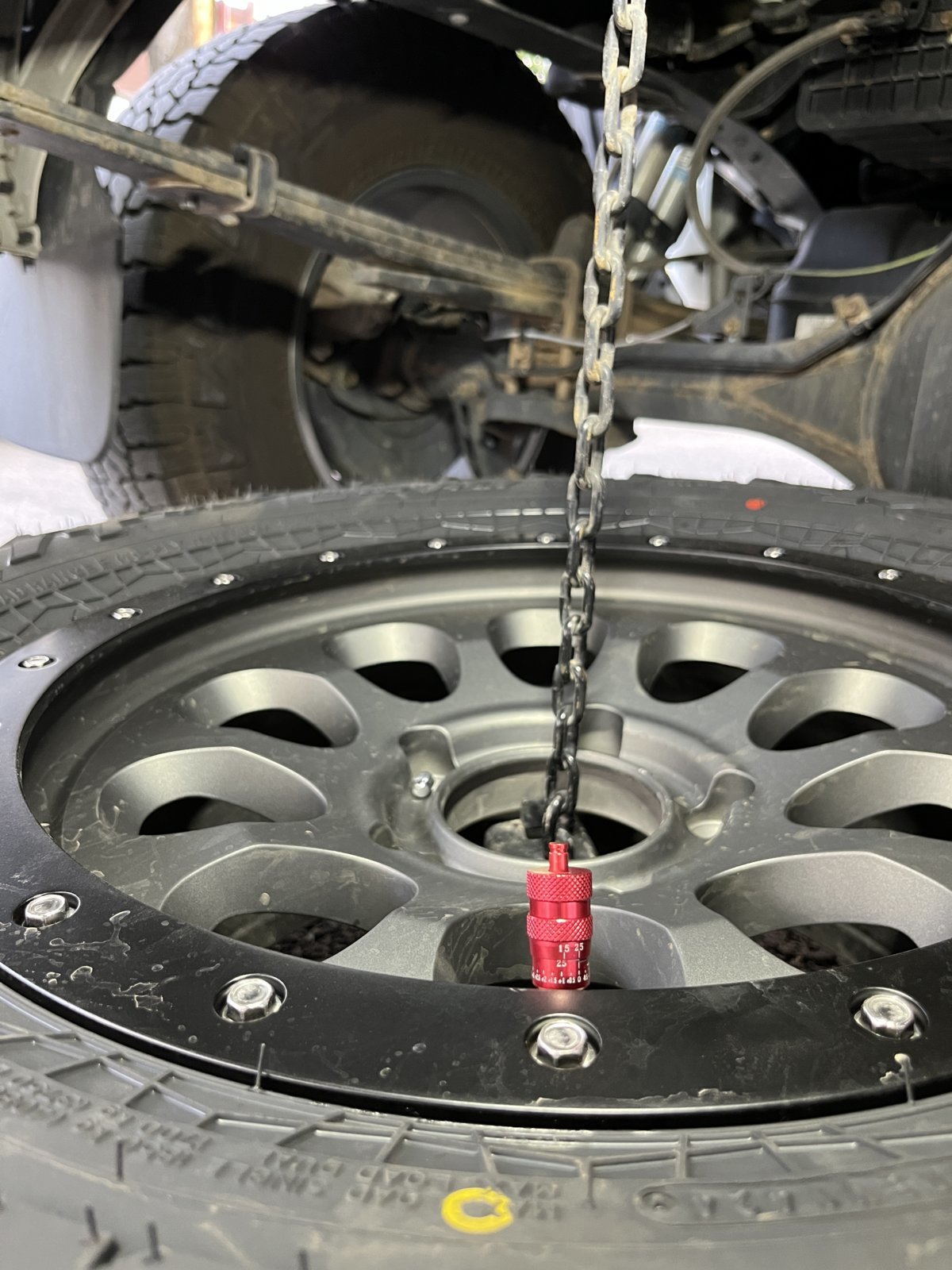

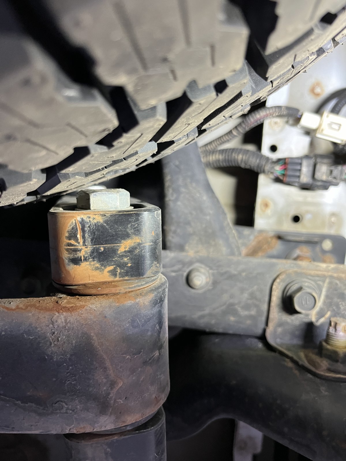

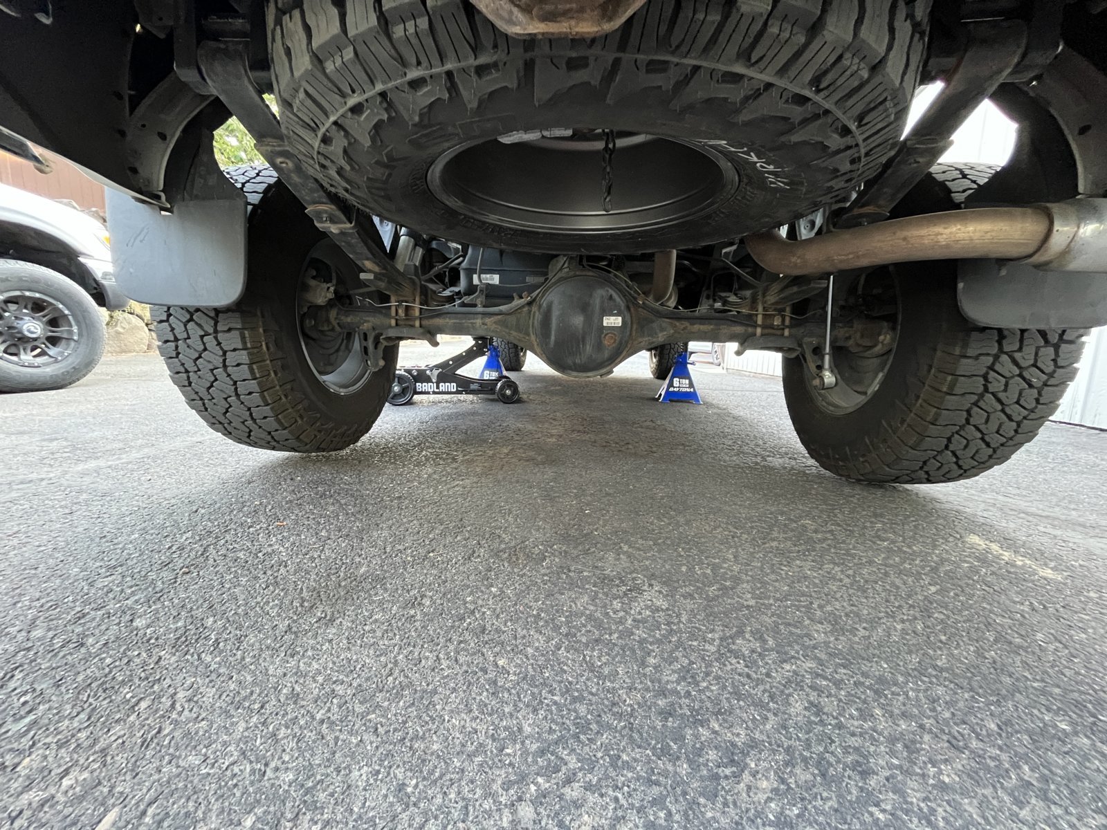

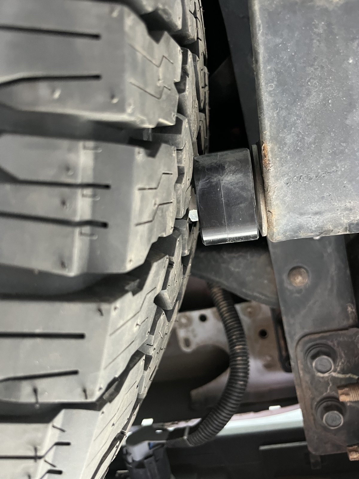

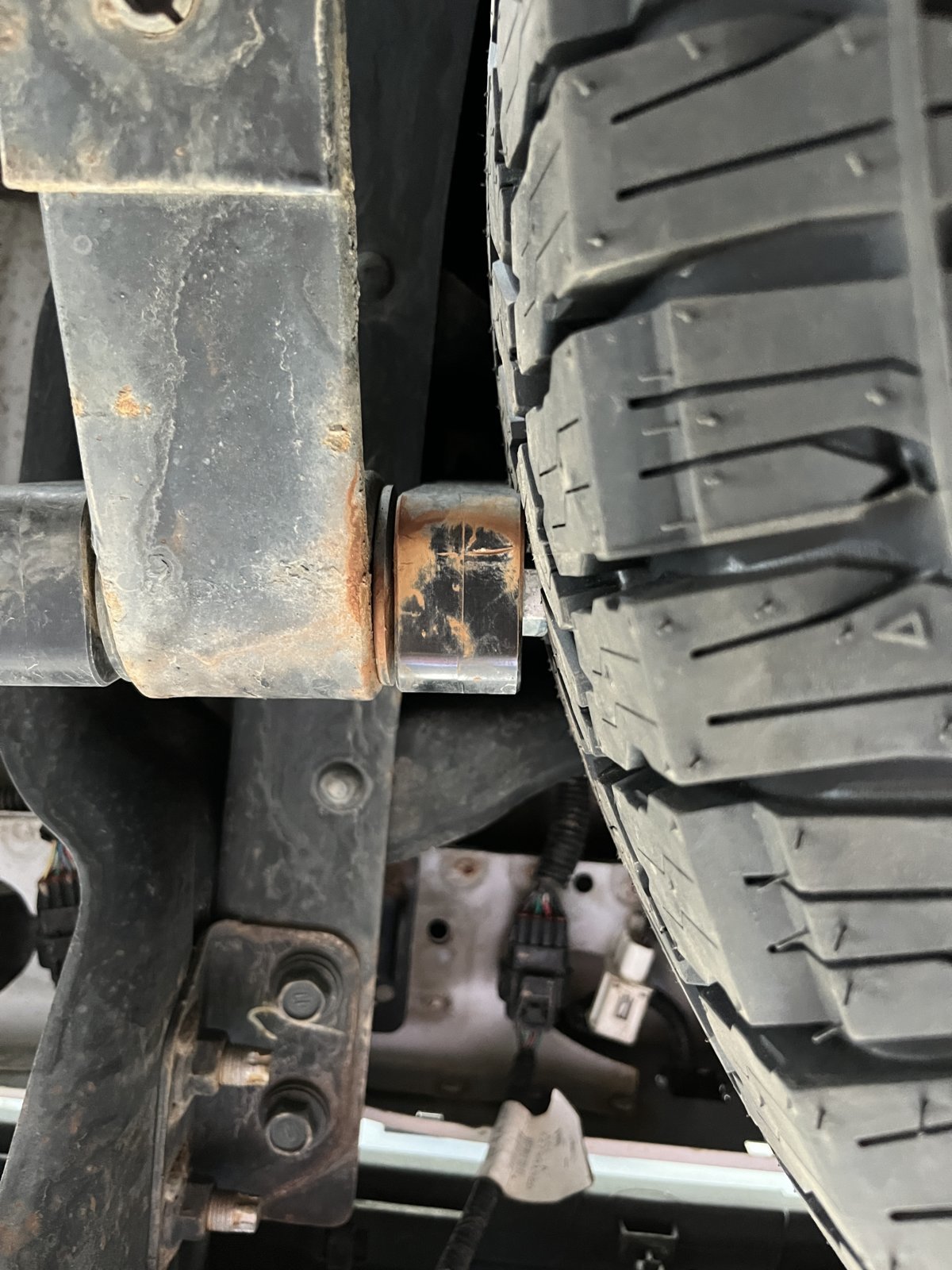

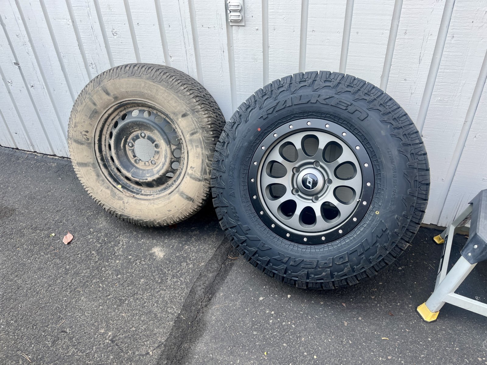

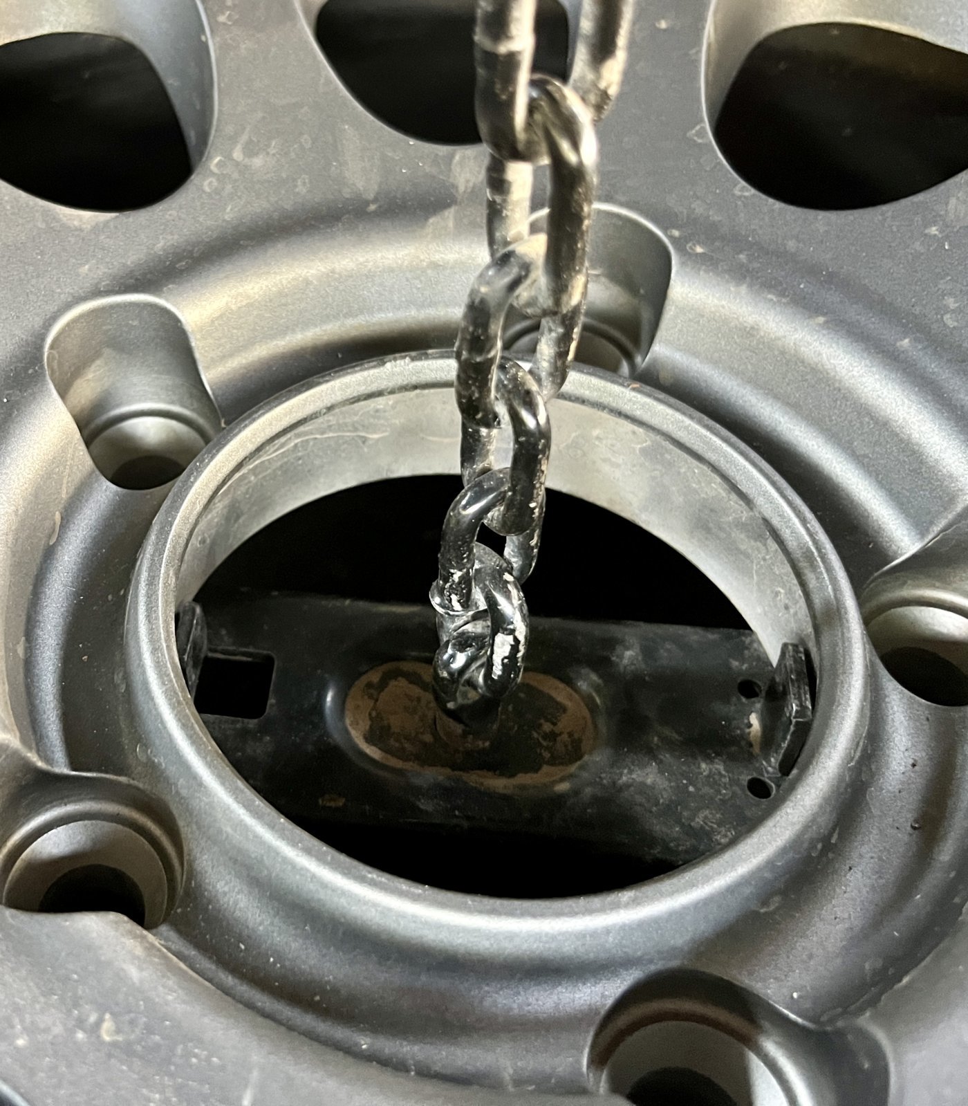

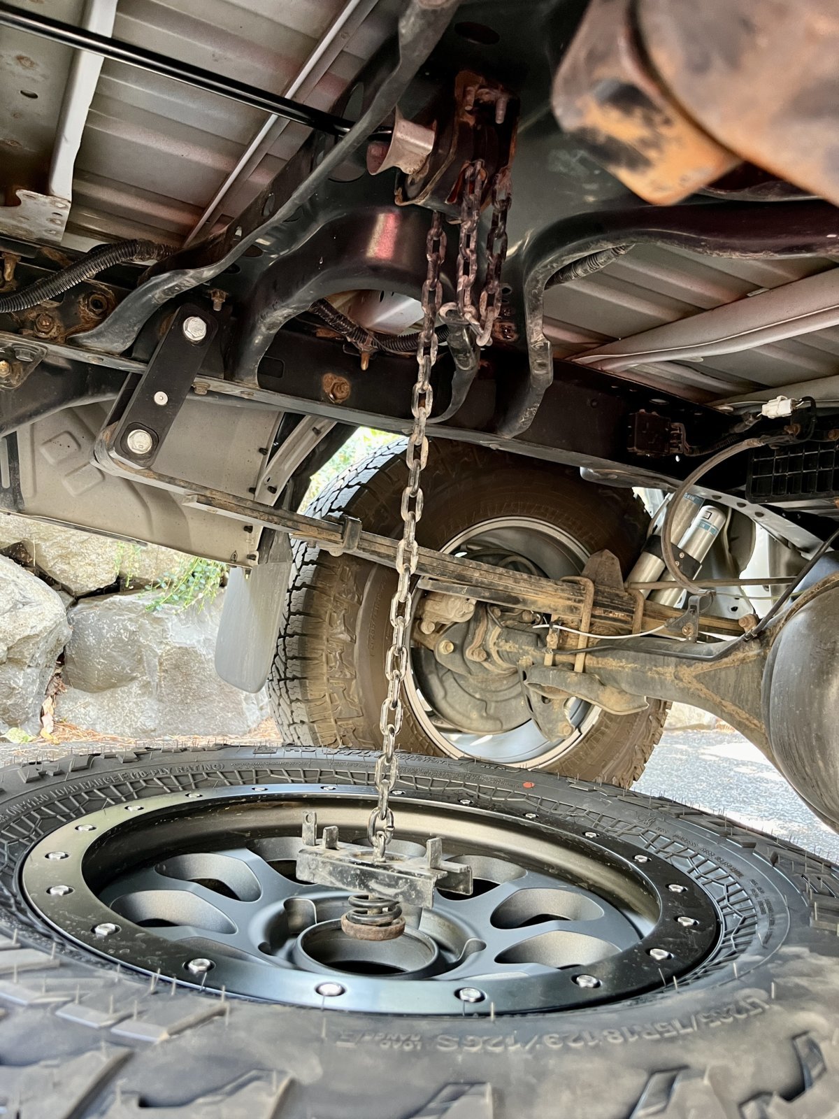

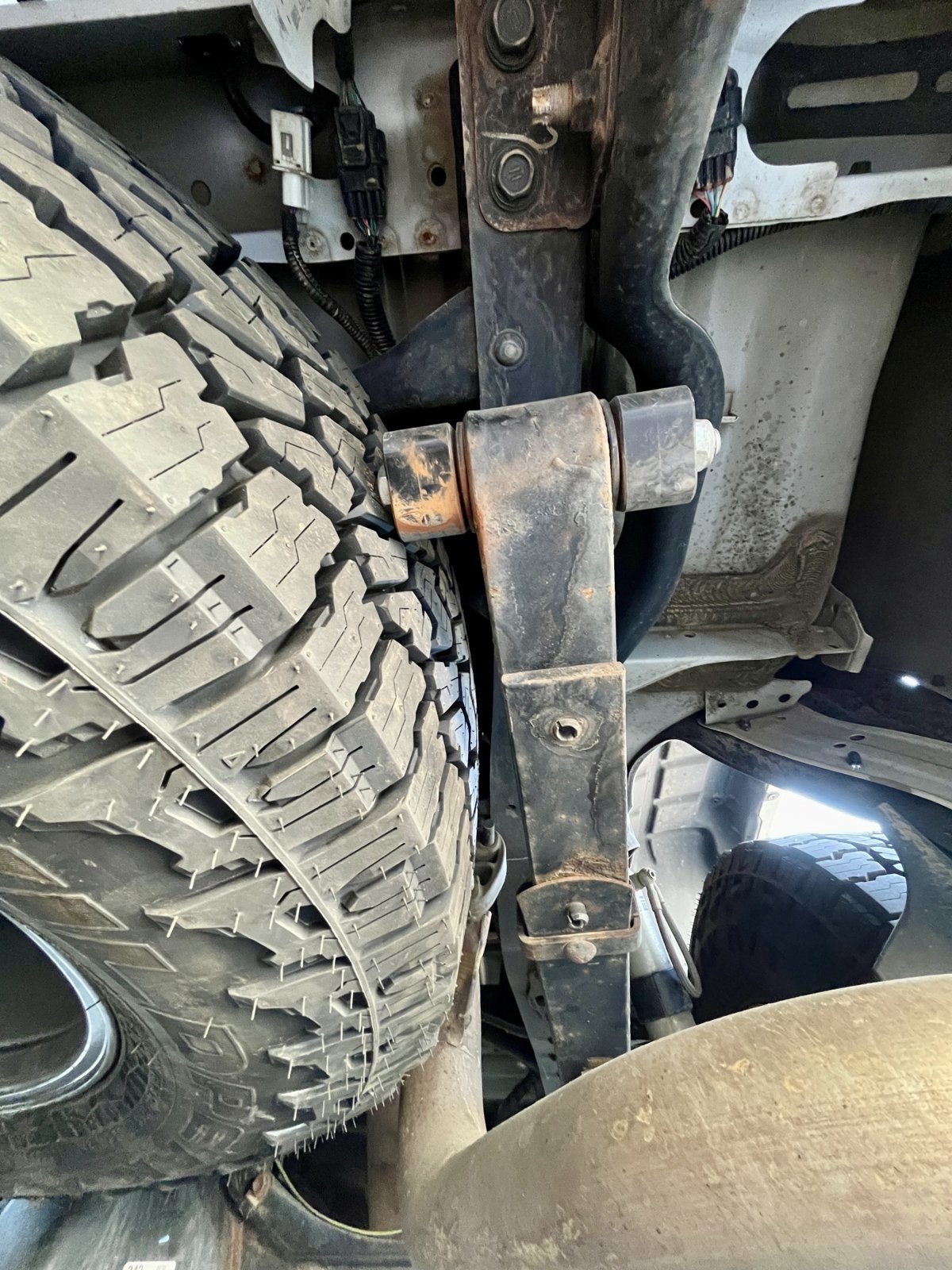

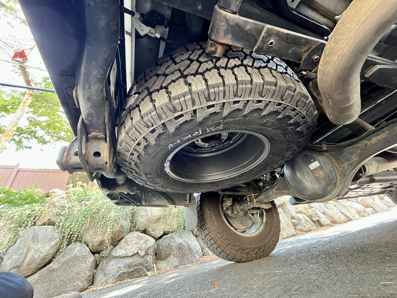

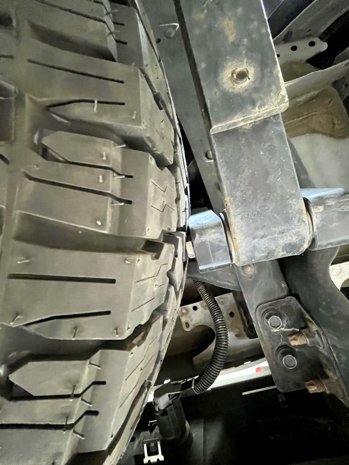

    I know there are older threads on this, but here’s some pics of a Falken Wildpeak A/T4W 285/75R18 (true 35” d, 11.6” width) barely squeezing in (have to remove stock guide brackets)

    Good to know! Man that is CLOSE! But as us machinists say…. Clearance is clearance :rofl:

    Did you jack the truck up to lift the tires off the ground for full droop? Maybe it’s the photo angle, but it sure looks as though the shackle will hit the tire when it swings forward at droop.

    Yep. Looks like he's gonna eat the tread up in those spots from the shackles rubbin on that tire.

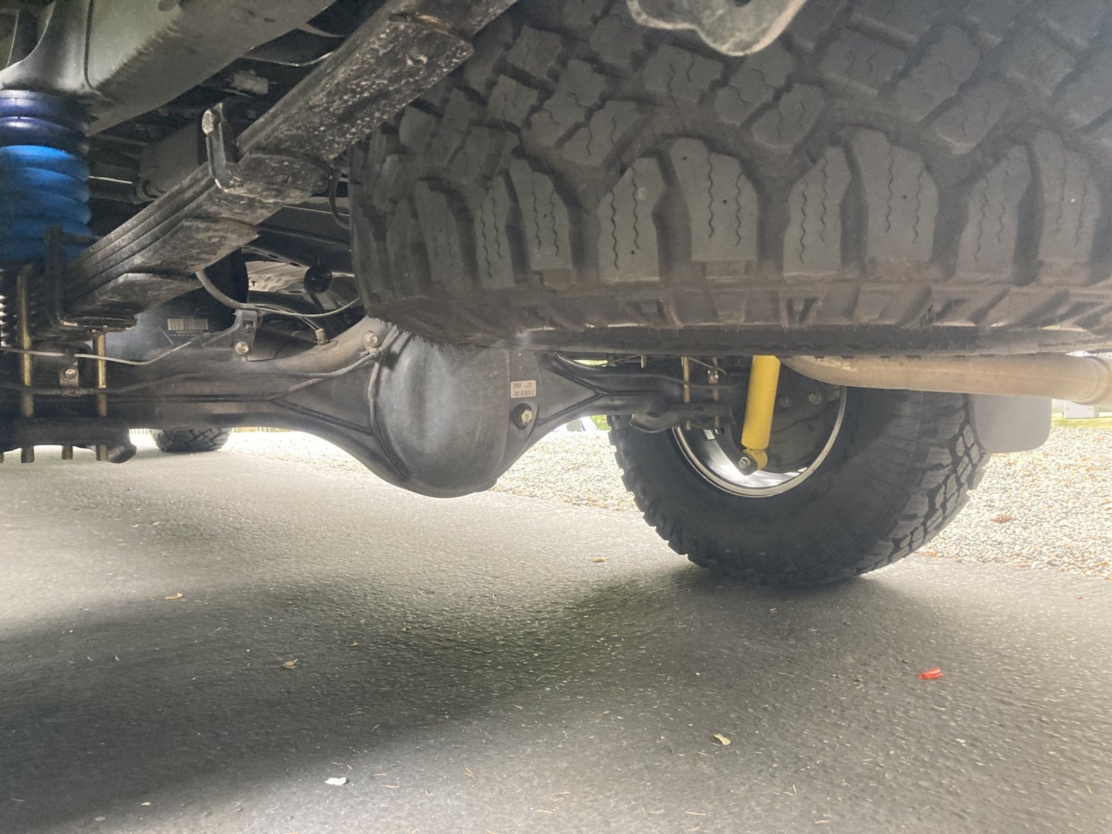

    315/70r17 also tight but some room.

    I haven’t, but sounds like I better check that out!

    Shackles are going to gouge the tire.

    I just got the rear up on jacks, and it is rubbing some

    But…I let the air out from 40 psi —> 20 psi, and I found a helper, so was able to push it further forward ( had been doing it solo)
