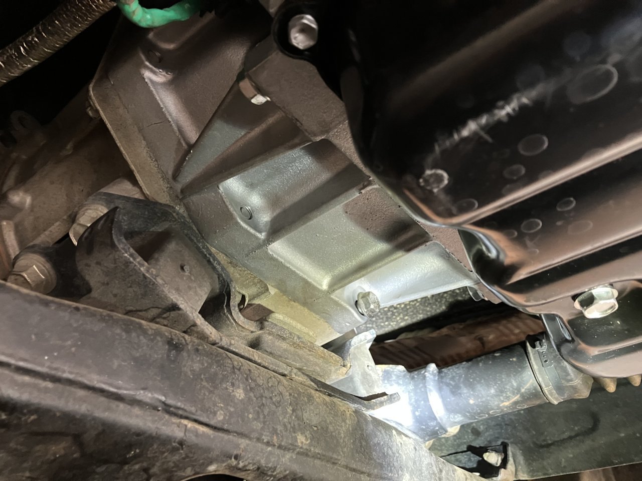

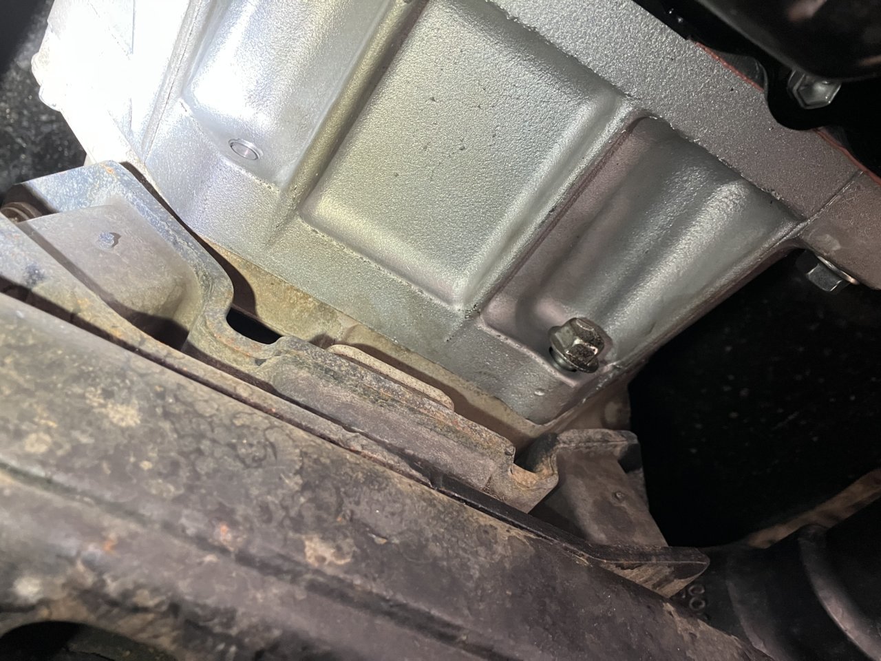

    Finally got my truck back. I was so happy to get outa the 2023 tundra! Got it home looked underneath and the idiots completely forgot to tighten one bolt connecting the transmission to transfer case. Anyone know the torque spec for this? Who knows what else they screwed up. How difficult is it to torque down a damn bolt. Seems like no one gives a damn anymore about anything other than their stupid cell phone. Plus they scratched the heck outa the drain pan which will now promptly rust. Going to call and waste my time raising hell with them tomorrow ask to have somebody else inspect the whole thing and check the fluid level since who knows if they even got that right. Todays world is absolutely maddening!

    Is the bolt supposed to come from that side? Why does it look like there’s a crack on the drivers side of the bell housing above the trans mount?

    I was thinking that too about the bolt. I can’t find a good schematic to see. And no it’s not a crack I thought it was in the photo and went back and looked its a scratch.
