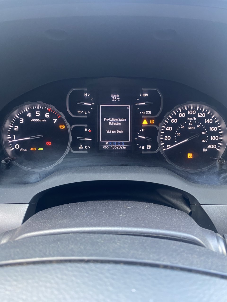

    My truck will randomly flash 6-7 different lights on the dash and give me warnings to pull over if towing and to contact dealer immediately. Wondering if anyone has this experience. And if so, what would it be. Happened when I left the dealership when I bought it a week ago, said they fixed it the TPSM but it came up again. Truck is a 2018 5.7 SR5

    Many times when this pops up here it ends up being a wheel speed sensor.

    If you just bought it, take it back and make them fix it.

    Take it back under warranty for a proper diagnosis and make sure they check the wheel speed sensors both physically and electronically in techstream.
    Lights coming on stores codes they can diagnose with.
