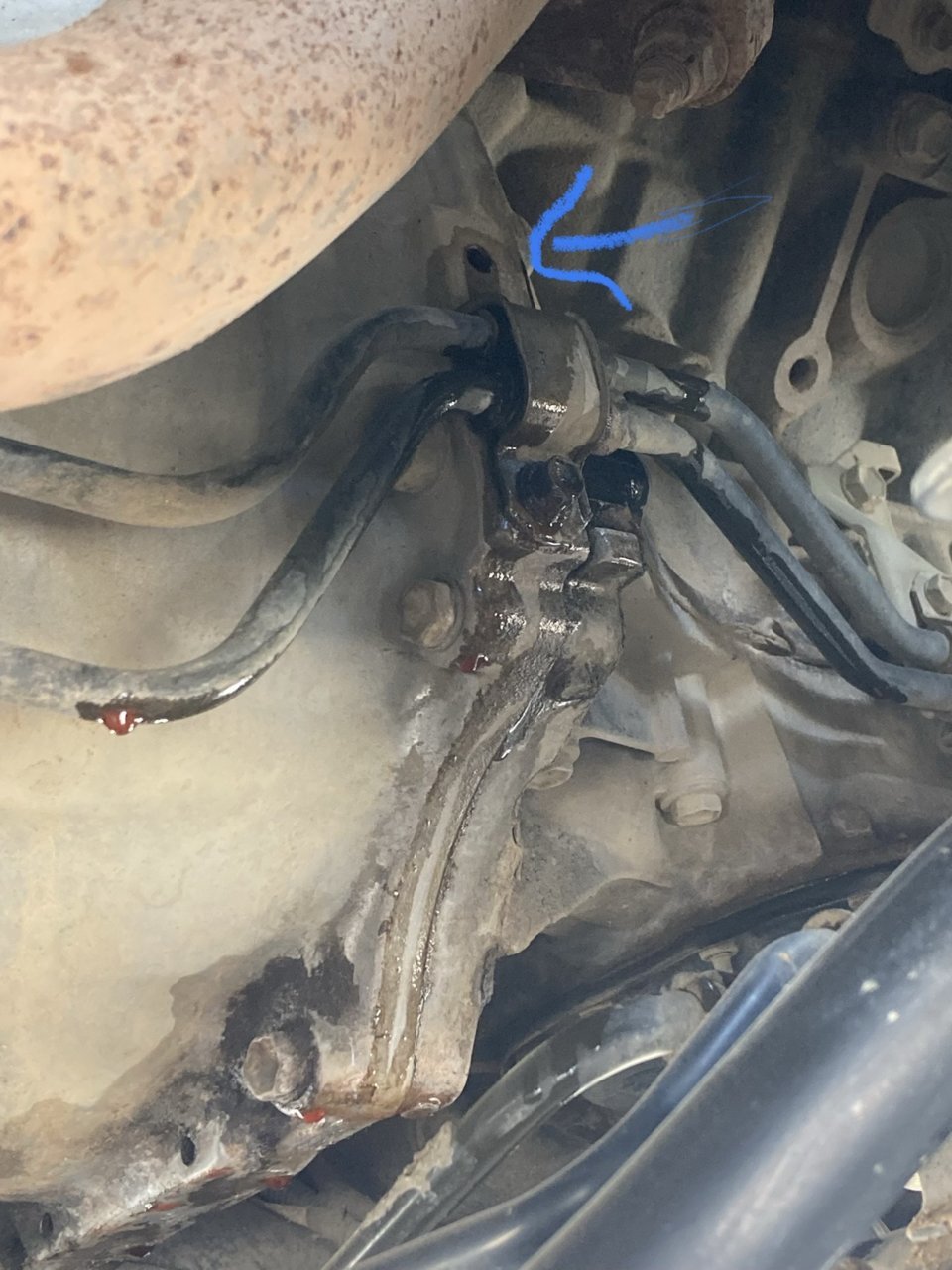

    I attached a photo. It's coming out of the sides of the Bellhousing. I'm thinking this is a problem with the
    A) Freeze Plug in the back of the motor/bellhousing area.
    B) Tranny fluid has breached a seal in the bell, tranny fluid cooler? Torque converter?
    C) I have no idea ??? thats why im here haha

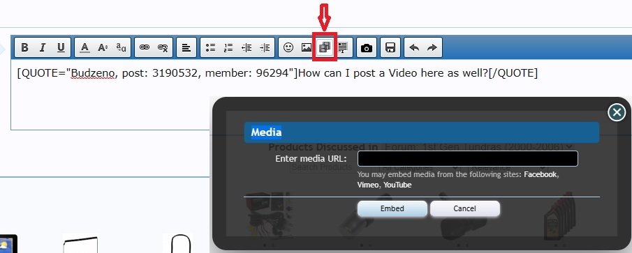

    How can I post a Video here as well?

    Is it for sure coming from the bell housing or perhaps from those transmission cooler lines in the picture? Maybe a pin hole spraying at the bell housing?

    Select the media button and input URL to video.

    here’s the video I had to pop it on YouTube to get it to load. Hard to see but yes it squirts out of the hole ABOVE the hardlines. Only when the truck is started is it squirting, obviously pressured.

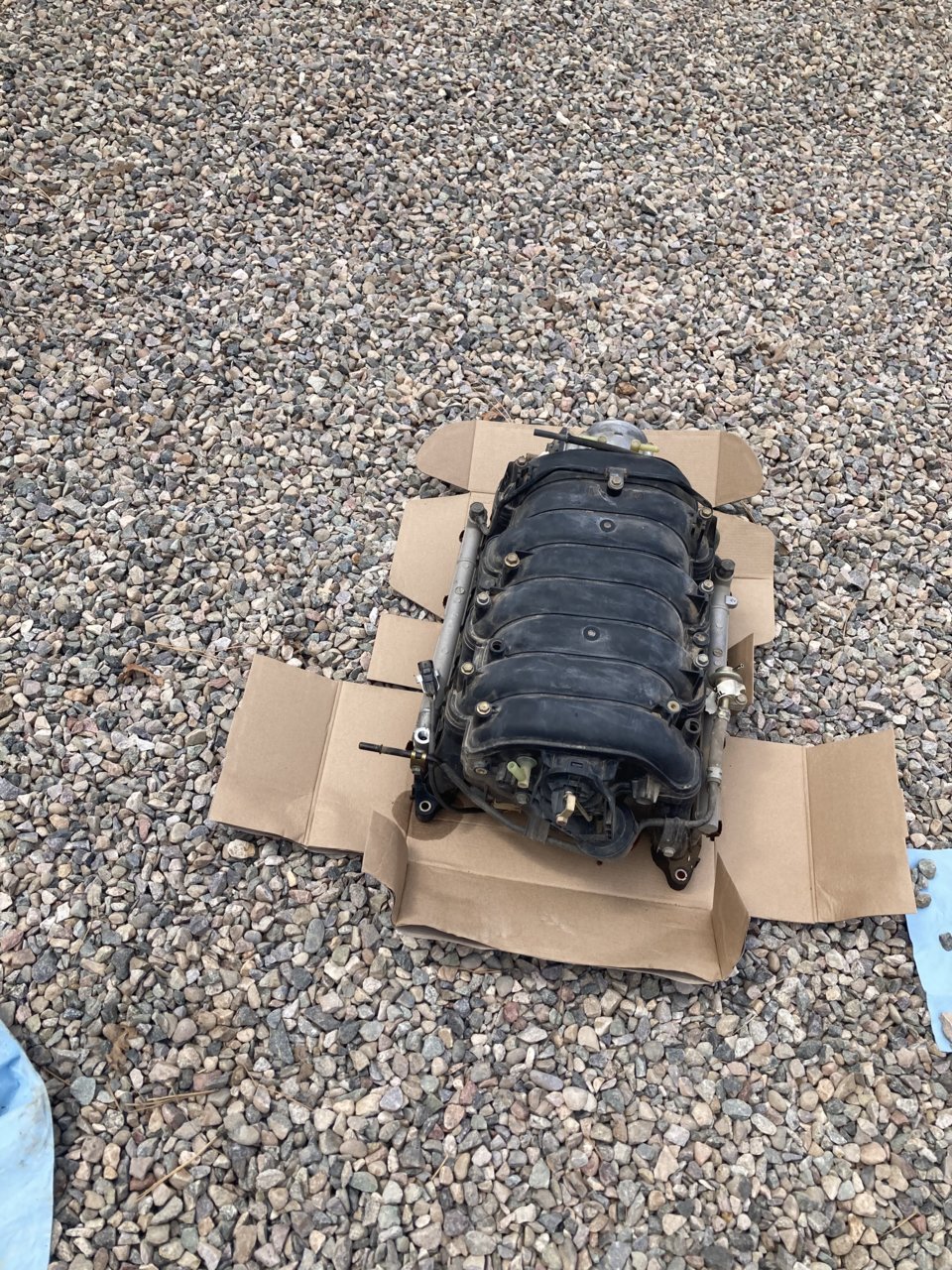

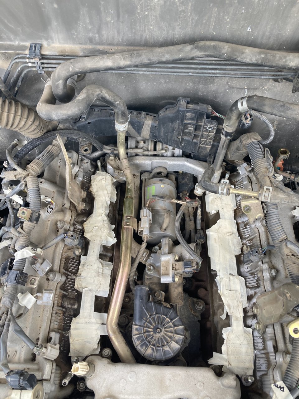

    I have the intake manifold off, i took that off yesterday to look in the V. Cleaned that bit up and taped off the top end. Heres a photo.
    Where am i looking for this crossover? Im assuming its not the pipe that leads from the water pump to the heater core tube because thats clean as can be.

    I understand the video is hard to see, but it is squirting from that hole. The hole is threaded as well. Its then leaking down. It is dry above that hole

    see sig for mods.....
    What's all that crap (gizmos) in the valley? I hope the unit in the rear is not the starter motor. I know NOTHING about the Gen1 Motors BTW
  10. May 13, 2023 at 10:54 AM

    That looks like coolant to me not tranny fluid. Those two lines are for the trans cooler (tow package) but the hole above the bracket securing it is supposed to be that way - not sure why? Maybe for another option/bracket/Lexus something or the other...
    I think your first guess, freeze plug, is the most likely scenario here. You can confirm that it is coolant and not ATF correct? It's definitely pissing, coming form between trans and block and there is really only one way that can happen. You will definitely need to pull trans unfortunately. If you wanted, you could certainly pressurize the cooling system to see if you can make it leak - might be good to have one on hand anyway to test the others. It's possible some shitty mix of coolant was there in the past, or lack thereof, and a little corrosion has set in.
    Truck looks clean underneath and you got an 05'. Hope you got a decent deal - just replace it and move on. They're not hard at all, it's just a lot of work to get to it.

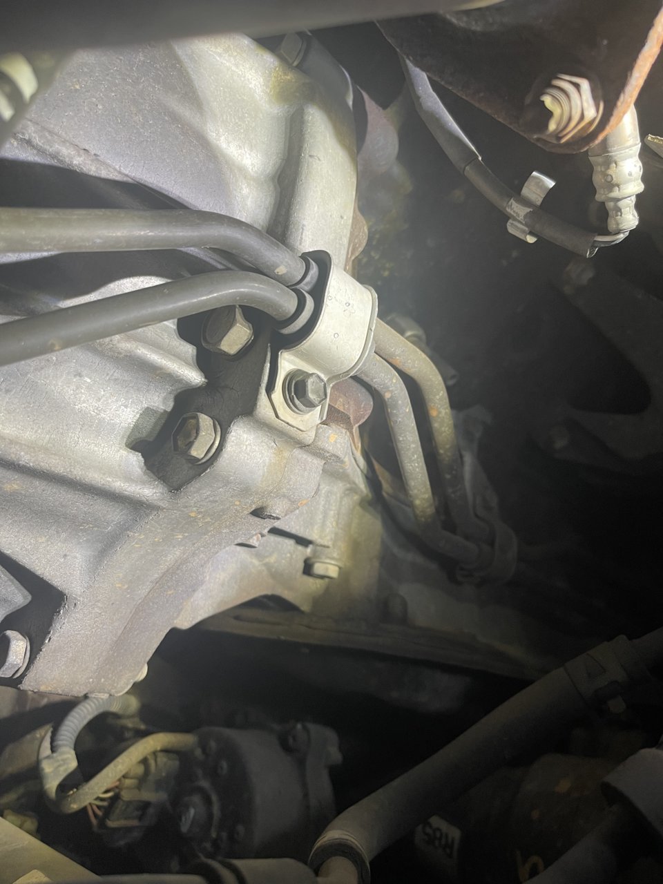

    More investigating just to be certain before I get deep into trans pulling. Pulled the secondary air pump and stuff out. Definitely a nest of some sort was under there. Cleaned it up good. And while I was there I starting thinking about the drain holes in the back of the V, why it only leaked while running, and where the drain holes go. I used a small hand pump and pumped water into that hole in the back of the V. No water underneath. So I just started cleaning the bell real good. I pulled the bolt on the view plate to clean it up. Bam a half gallon of coolant instantly flows out of the gap, rodent nest particles and all…
    This I’m assuming, was all coolant that had been leaking from the water pump and upper o rings, draining down into the bell, and literally being stuck and filling up like a pool. I’d assume the small metal plate to see the flex plate would have leaked it all on the ground but that sucker was sealed up good from dirt and grime.
    Pretty weird turn of events.
    after I drained and reassembled the top end, I filled the coolant again, fired it back up and it’s running great. No squirting coolant.
