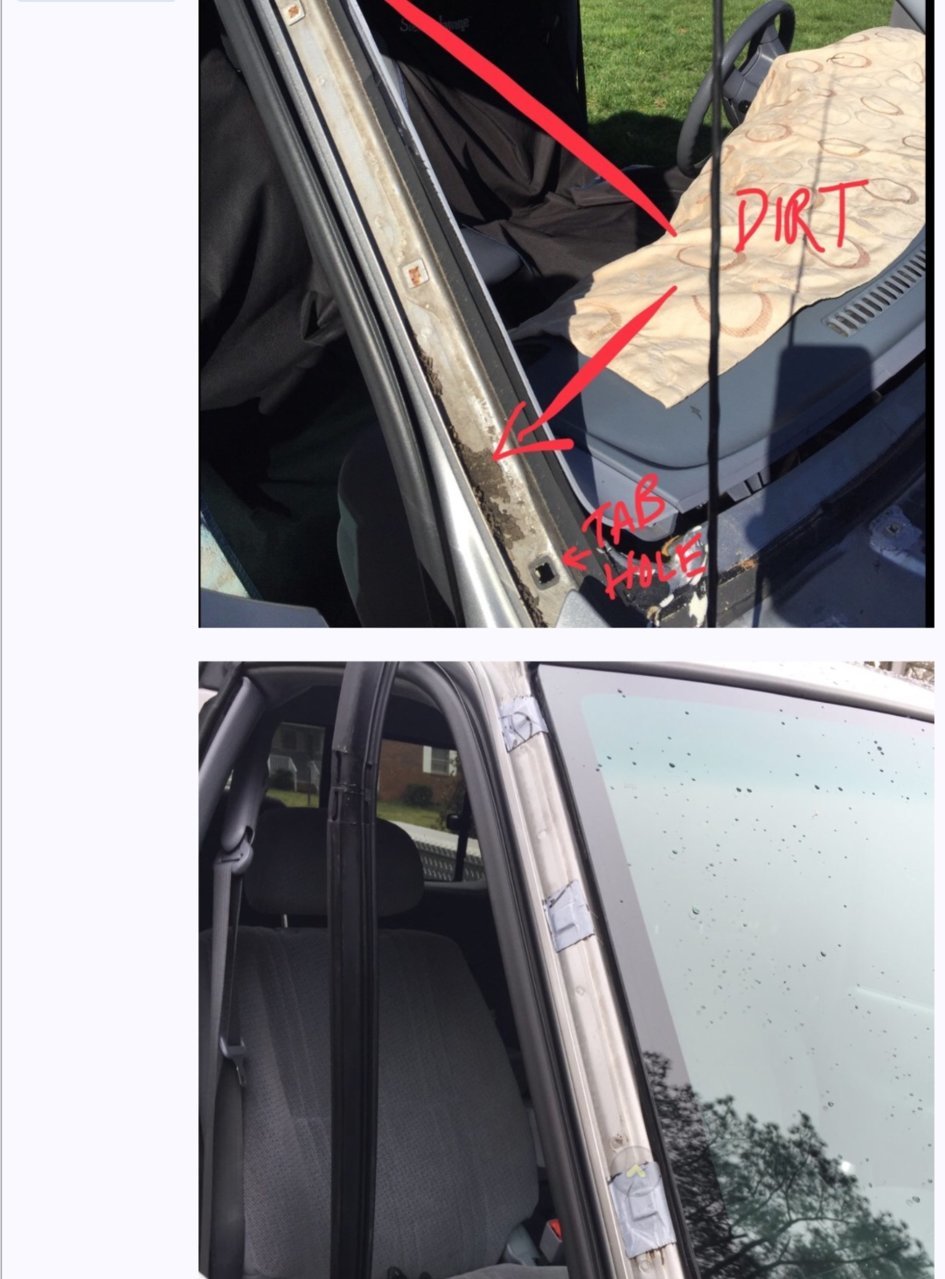

    Seems this drivers side leak issue pops its head up here every so often. Last member had to replace his entire interior fuse box from a long time leak which corroded the device.
    Have you addressed the leak issue? My theory is if its not coming from the glass its coming from the pillars. Here is a pic of the pass side clips where the rubber gasket deteriorated. You access by pulling the rubber trim back gently. I found this out when having my bad glass (due to sand blasting) installed by a pro.
    Check out my build page for more tips.
