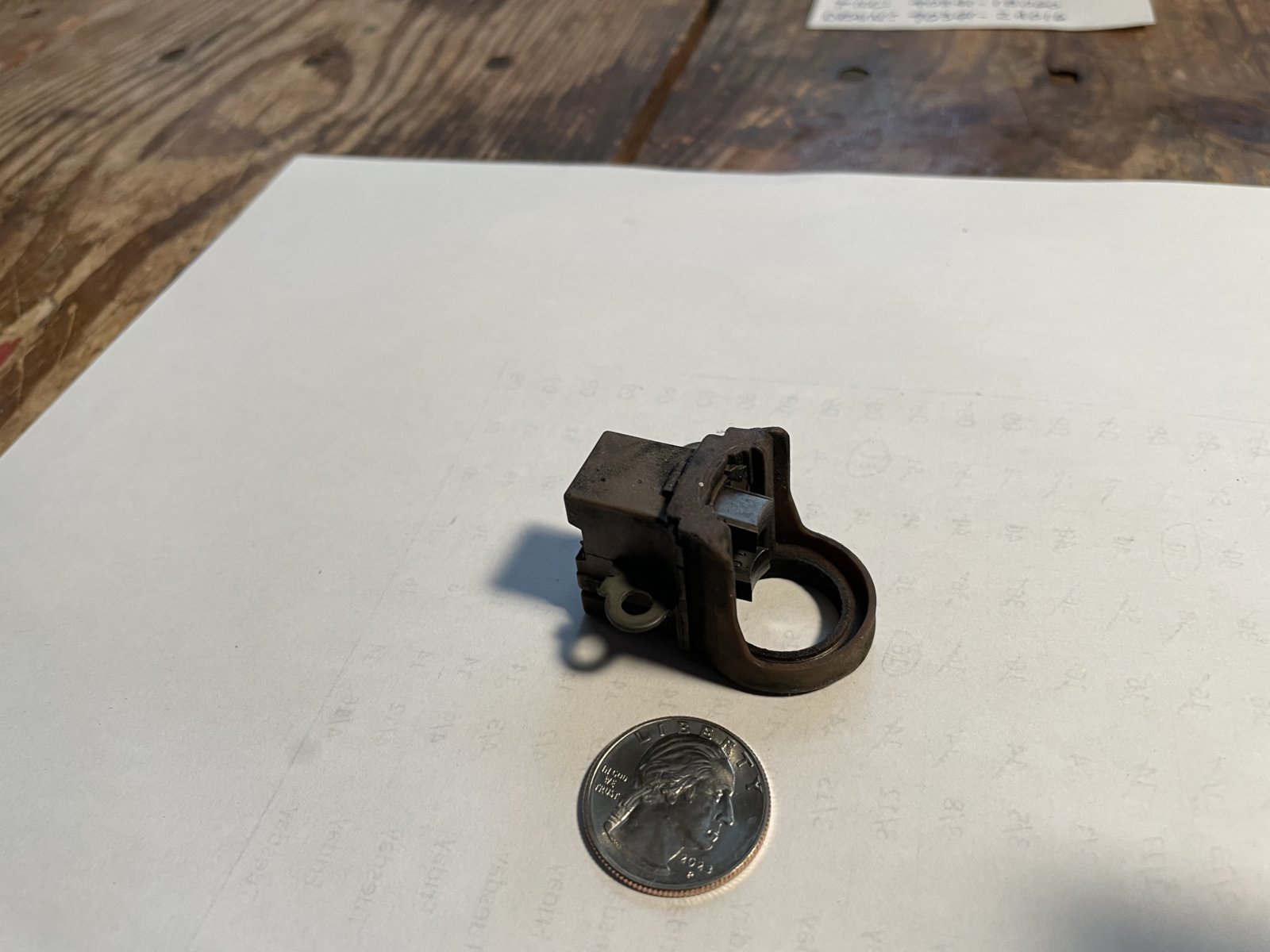

    FYI. When we say "alternator" we often really are referring to the primary wearing part of the alternator: the brushes. A $25 part that can be replaced inside the alternator. It does require removing the alternator. It does NOT require you shelling out a crap pot of money. As a point of reference: my 1997 T-100 is on its second set of replacement brushes (8,000 miles ago) and am now at 270,000 miles on the original alternator.
    Here's what that part generally looks like:

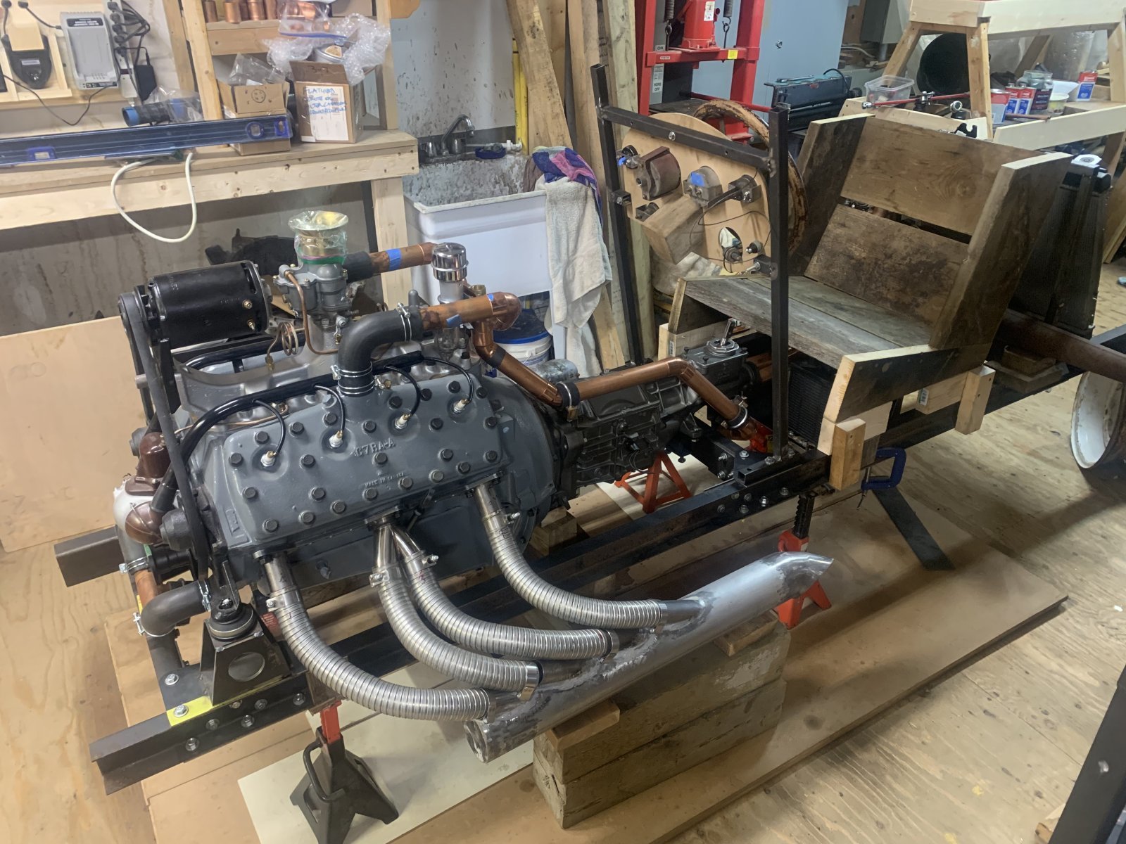

    Ok now we need pics of this flathead and of course what it's in
  16. Jun 10, 2024 at 4:30 PM
    Canman
    Canman [OP] New Member
    Jan 6, 2024
    #109736
    878
    2007 Crewmax Limited
    Haha!
    I’m building a tribute to Richard Scaldwell’s GN Jap. Petro Shekhter created his own tribute with a beautiful 3D rendering. I’m going to build it as a single seater as per Petro’s model. Richard’s 5L air-cooled V8 is only one of 3 in existence, and the only one working. So, instead of that, I decided to use a Ford flathead V8 kinda keeping with a pre-war (WW1) feeling although it came out much later in 1932. Still a lot to do…
