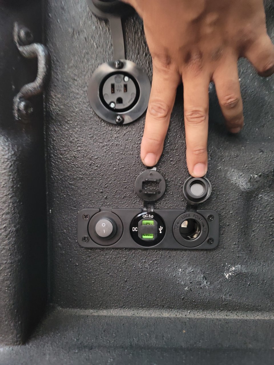

    I added a couple of USB and 12V plug with a 120 plug to connect a generator when I'm at the track. In your case I would determine how many lights will you be running and for how long because you might need to add a second battery to do multiple lights and not worry about draining your cars battery for start up.
