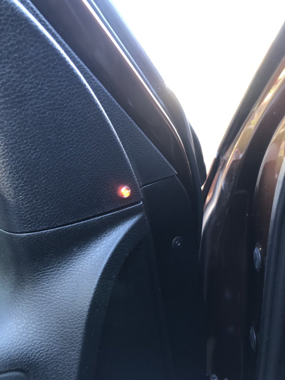

    I am almost certain the ECU does a BSM systems check. If the system doesn't detect the LED indicators it will most likely trigger a BSM fault.
    A possible alternative approach is to apply the DIY mod someone posted here on how to relocate the indicators.

    The buzzer is in the drivers side c-pillar for RCTA. The sensors are in the rear bumpers. The main ECU uses the input. If the lights aren’t there to complete the circuit it will complain at you. There are people that have wired an LED into the sail panel that serves the purpose. I added the factory BSM/RCTA to my truck (it’s not an option from the factory in the Pro), and used the Boost Auto mirrors.

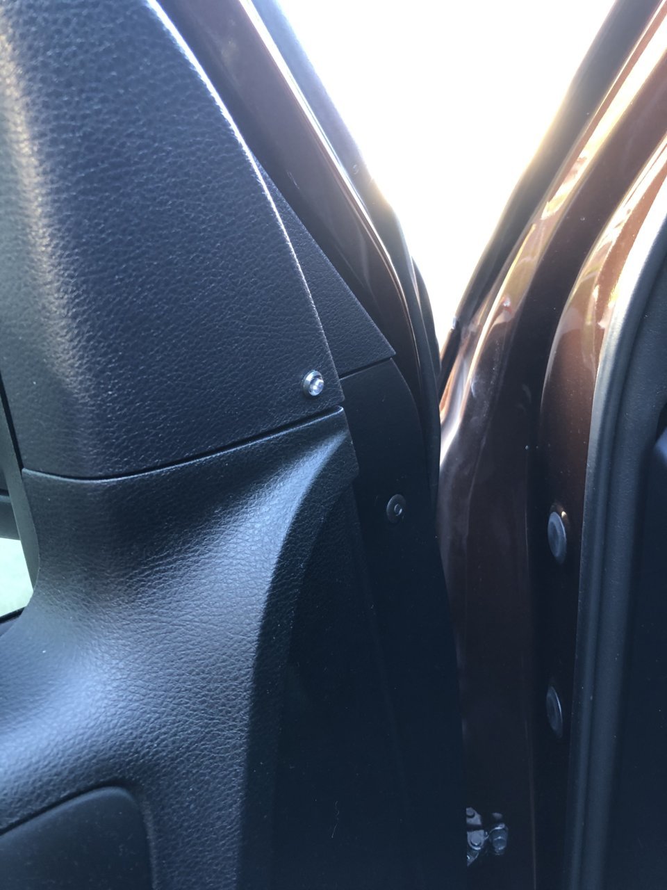

    Buy the power folding ones and add some inexpensive LEDs in the sail panel for the BSM indicator lights.
    Then you’ll have all the options.
