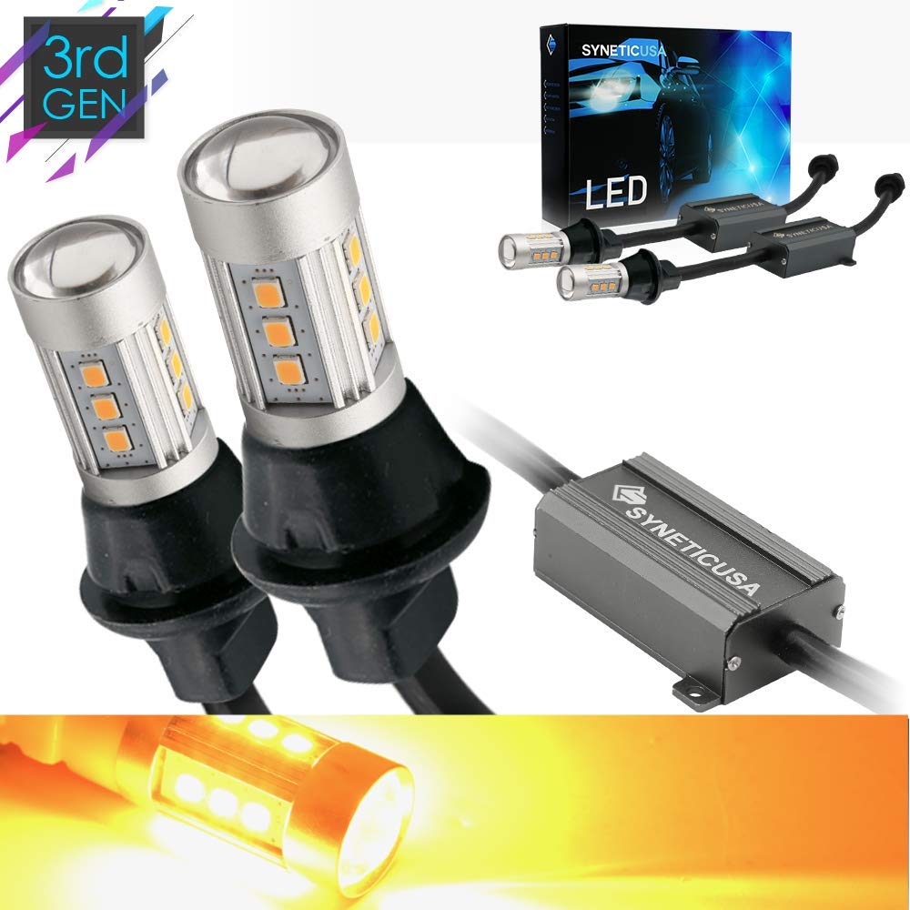

    Installed some new LED front signals, much more visible.
    LED on Driver side, probably a little glare in pic.
    Not bad for $26.00 I will need to get a set for the rears.
    Not finding a great way to mount the resistor block on pig tail, 2-way taped to washer reservoir and headlight housing. Hopefully it will last a while. Also need to seal up harness @ pigtail, protect from dirt/moisture. Have some Shrink tape ordered.
    https://www.amazon.com/gp/product/B07J5TJV5P/ref=ppx_yo_dt_b_asin_title_o02_s00?ie=UTF8&psc=1
