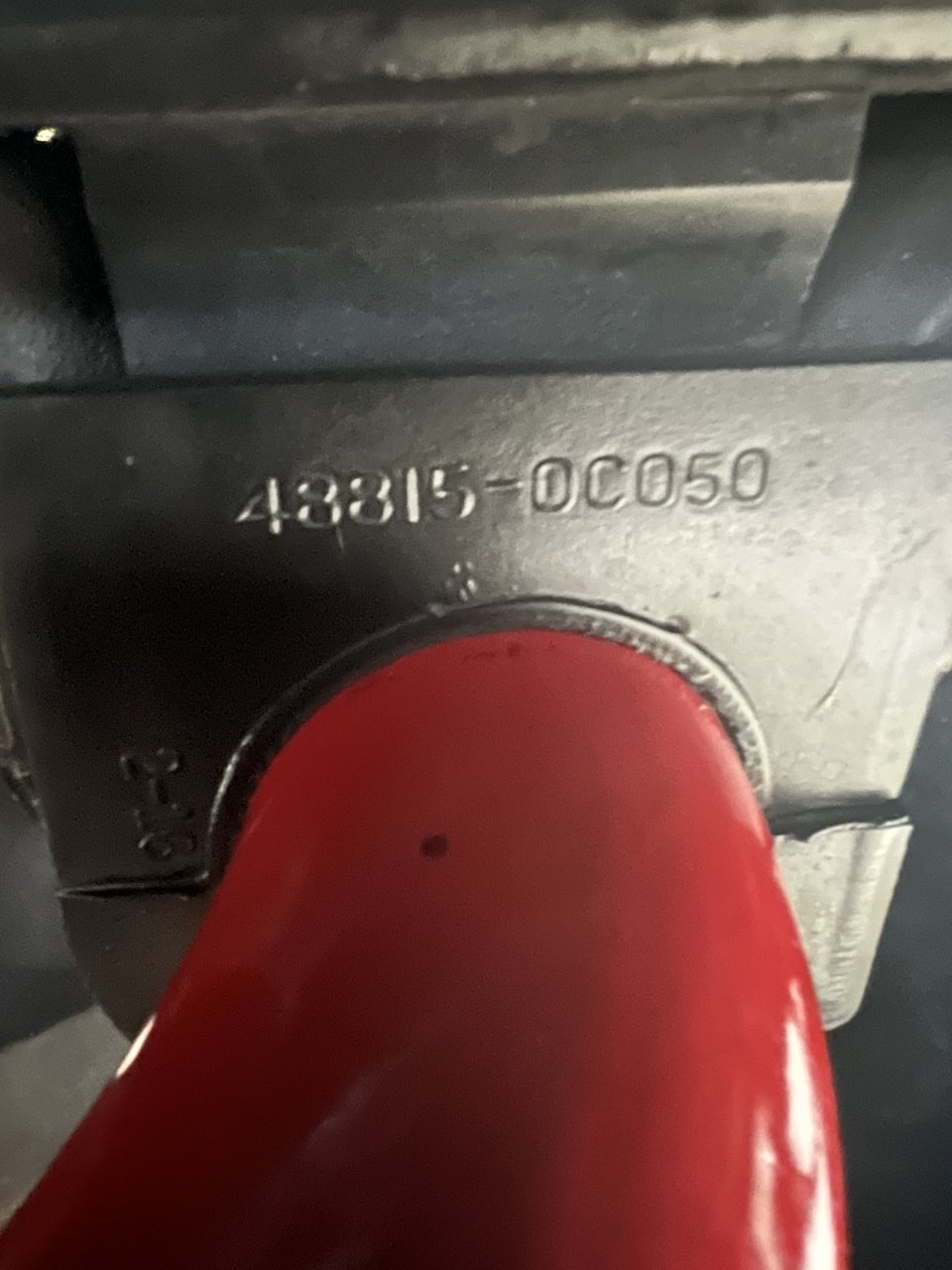

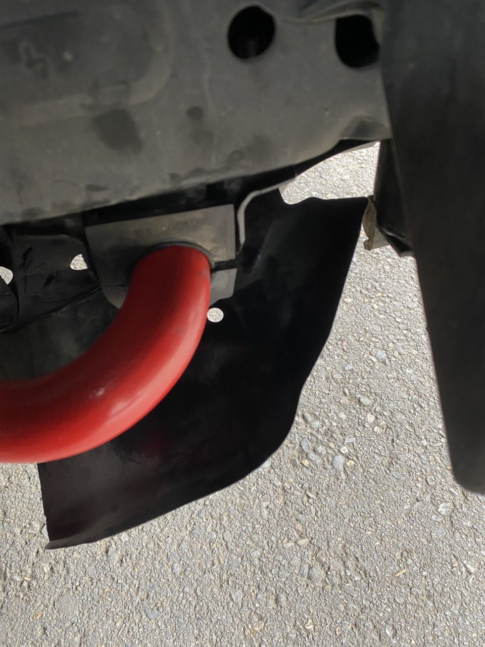

    32C4E89D-9BF9-408D-B1CF-70B4FC5CFC6A.jpg Anyone know how to get rid of this space on the front sway bar grommets. I just installed it and I can’t get rid of it, is it normal? I installed one on my last tundra and it closed up after driving it but this one won’t close up…torqued the bolts to 51 ftlbs.

    Did you just swap in the TRD bar? It’s a bigger OD bar than the stock black one, so you need to use the TRD bushing.

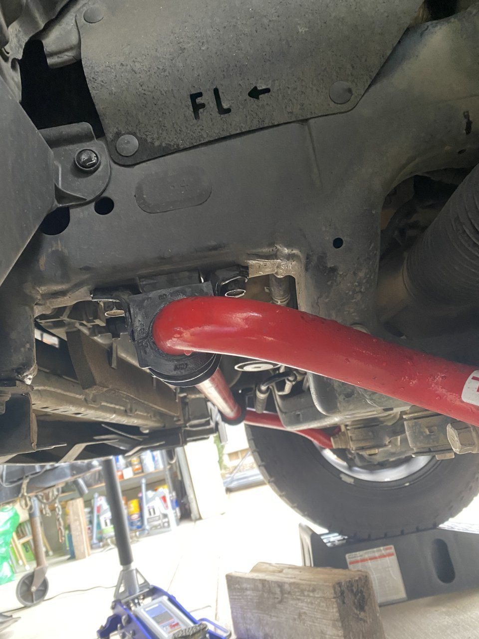

    Same thing happened to me when I put mine on. Check the other side. You are missing a plastic spacer that goes in between the from and the bushing. It looked like it had been missing from the factory. Here is what I order. Not sure why it's sideways. 20220219_192252.jpg

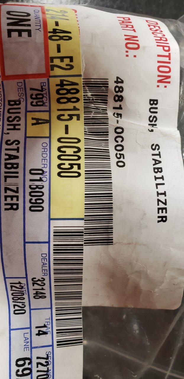

    I have a sport. So it’s always had the TRD bar, so I may be wrong on the bushing. But here’s the part # for reference. No gap either.

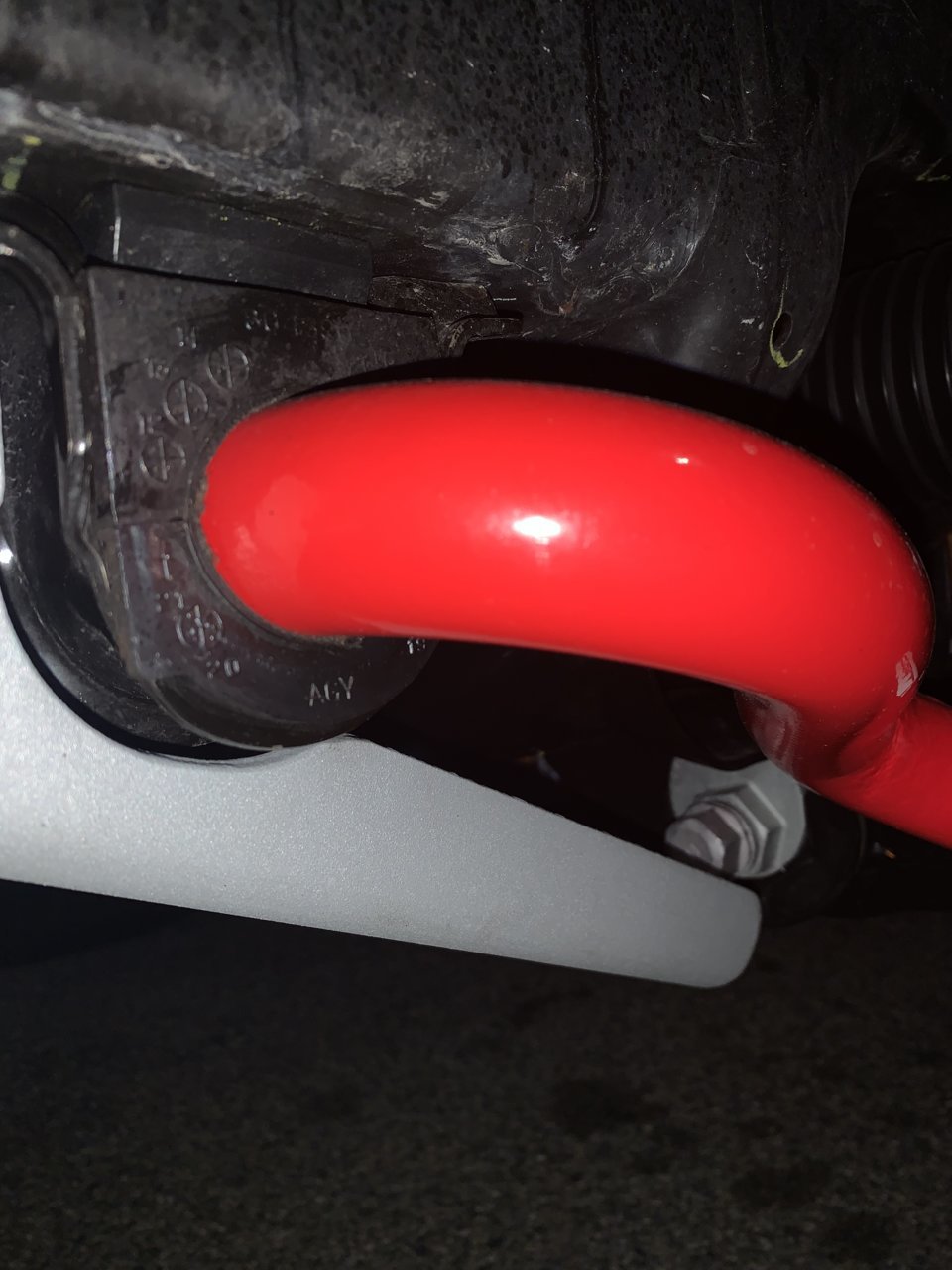

    Yes, and I pulled the grommets off today and regreased them and made sure the open end was towards the front of my truck this time tightened it up and it’s all good nowE3C83FF3-F51D-4107-A060-A9F9C8071F84.jpg

    If anything make sure the open end of the grommet is towards the front and you don’t need special sized grommets for the trd sway bar.

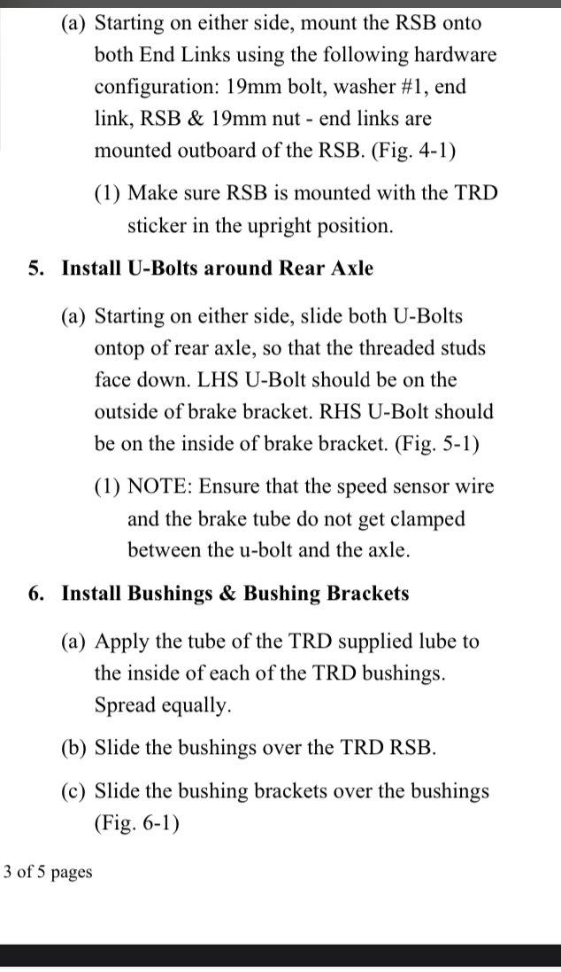

    This is for the rear, but per the instructions you are to lube the bushings.
    bulldog93 and snivilous like this.
