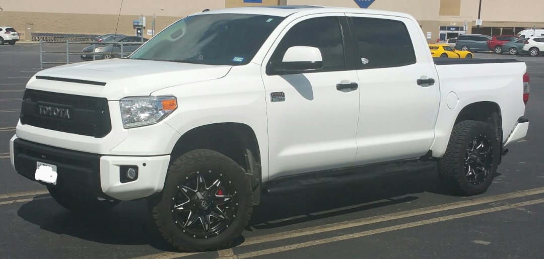

    I didn't go pro, but did Bilstein 5100's all the way around on 20" tires. Top setting, and used 2/1 Coach Builder shims on front. On the rear I used his +2 shackles replacing the bushings while I was there. If I'm not mistaken it's Bilstein either way you go, but a big difference in price.

    Skippy, what tire size do you have.
