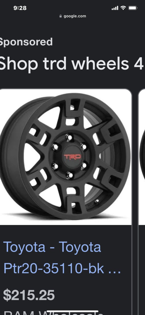

    I am looking at putting some TRD pro wheels on a this setup. 17s from a new Tacoma /4Runner.
    I read through a lot of threads on the matter and I do know they fit but the back spacing is a little funky.
    Those that have them from what I can tell are pretty conservative on the tire size but then they don’t have the lift.
    Well I found a set that has
    34/10.5./17 tires
    Any idea if these would fit/not rub ?

    These are the wheels in question

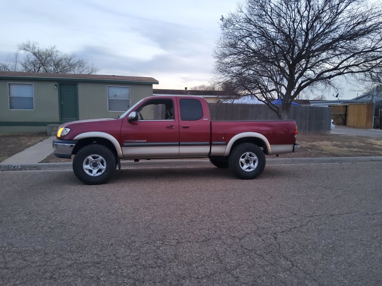

    This is how it currently sits on 265/65/16

    I'm on 33x10.5x16 with about 2.5-3" lift and it only rubs turning left through bumps, and that's only because my caster is off. I'd so go for it and trim/hammer what you need.

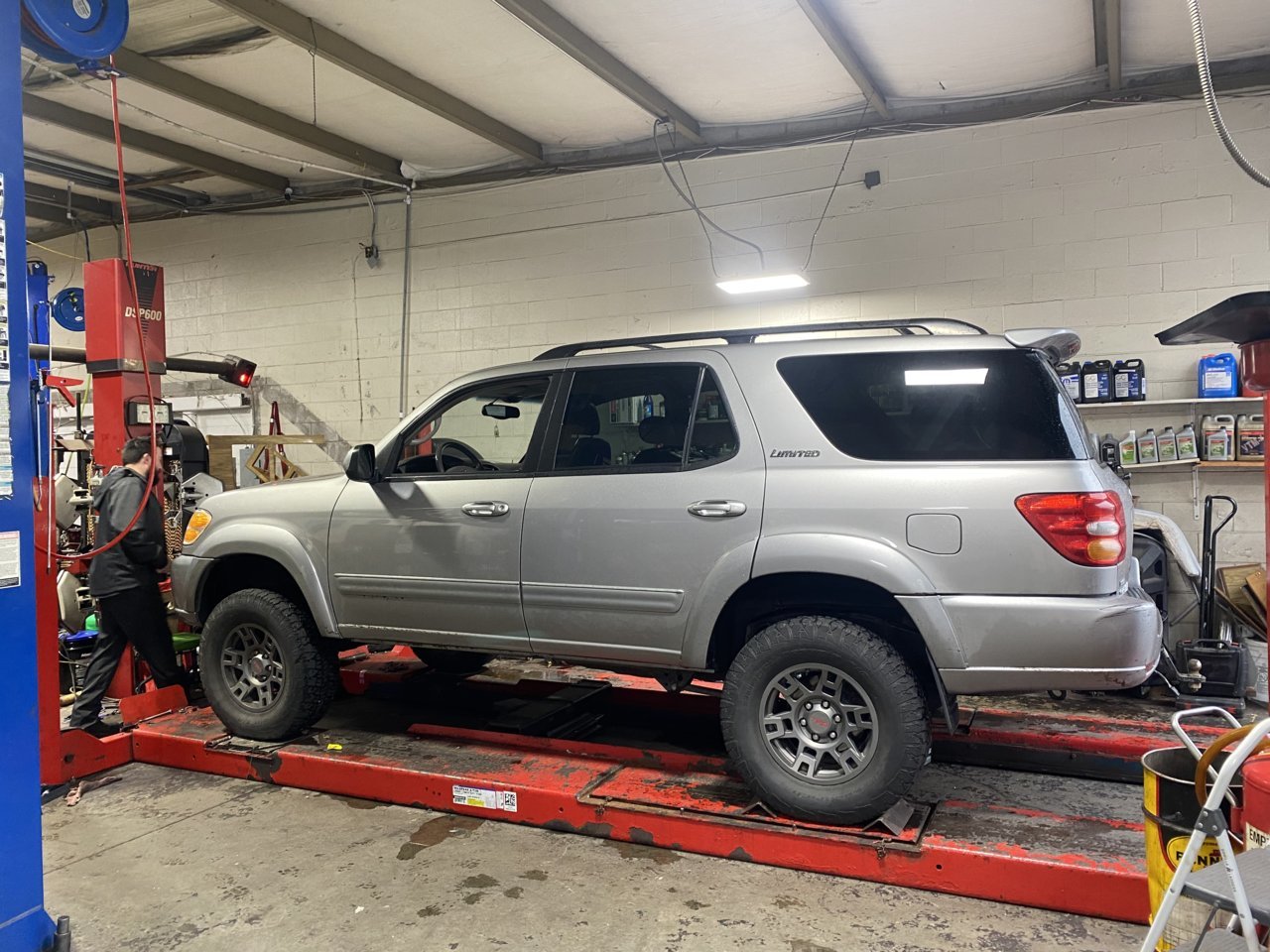

    This is an 03 sequoia with 17” TRD wheels and worn down 285/70r17’s. It has 3ish inch lift front and rear but does have wheel spacers. We’re gonna test fit some 35/12.50’s but I think they’ll rub the pinch a ton. He’ll probably end up with 285/75’s like me.
    The 34/10.5 shouldn’t come close to the uca. It might rub some on the pinch weld and front bumper. Depends on how much you’re willing to cut and hammer.
