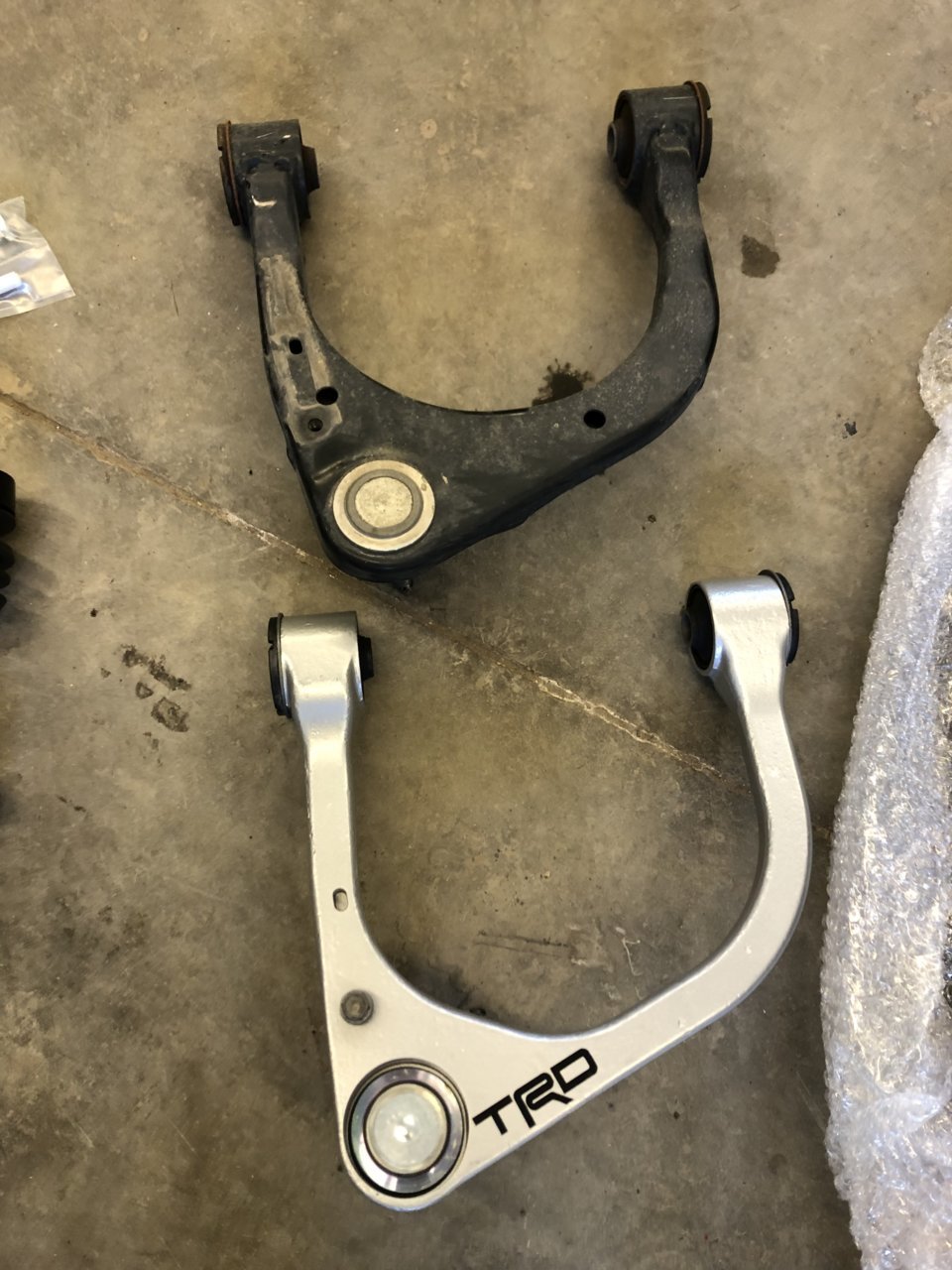

    can you send a picture of the bottom of the TRD ball joint.
    Curious if the ball joint is angled or straight.
    also is it shorter (from bushing to ball joint) then the stock one

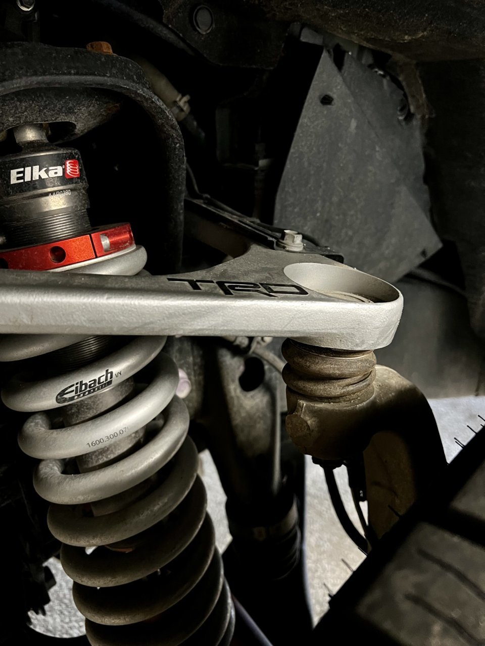

    The ball joint sits lower in the arm than the OEM one. This is on the truck now and set 2.75” above stock height.

    I changed the driver side UCA tonight and it wasn’t too difficult. It’s surprising how easy the ball joints come apart with a light tap. Moving the ECU out of the way was a little pain but not too bad.
    Changing the 650 lb/in springs that came with my King Suspension kit to 600 lb springs to better match my 2WD was much more of a pain especially using my simple spring compressors.
    I hung them on my scale: 7.16 lbs for the stock UCA and 11.51 lbs for TRD UCA so quite a bit beefier.

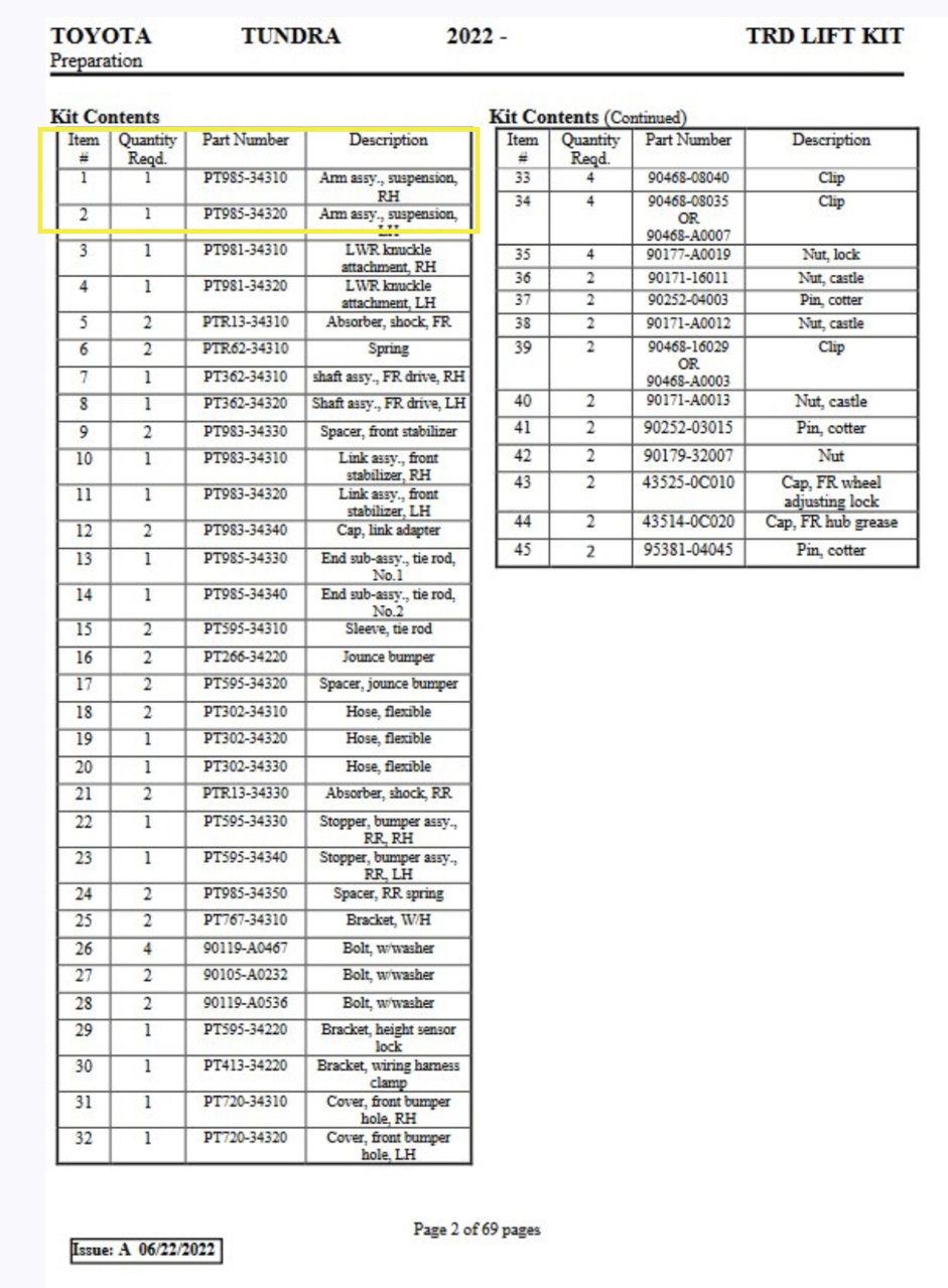

    Hi can anyone confirm part number for UCA’s. Someone listed the part number above, but when I looked up the trd 3inch kit it shows different. I’ve added both to my cart.

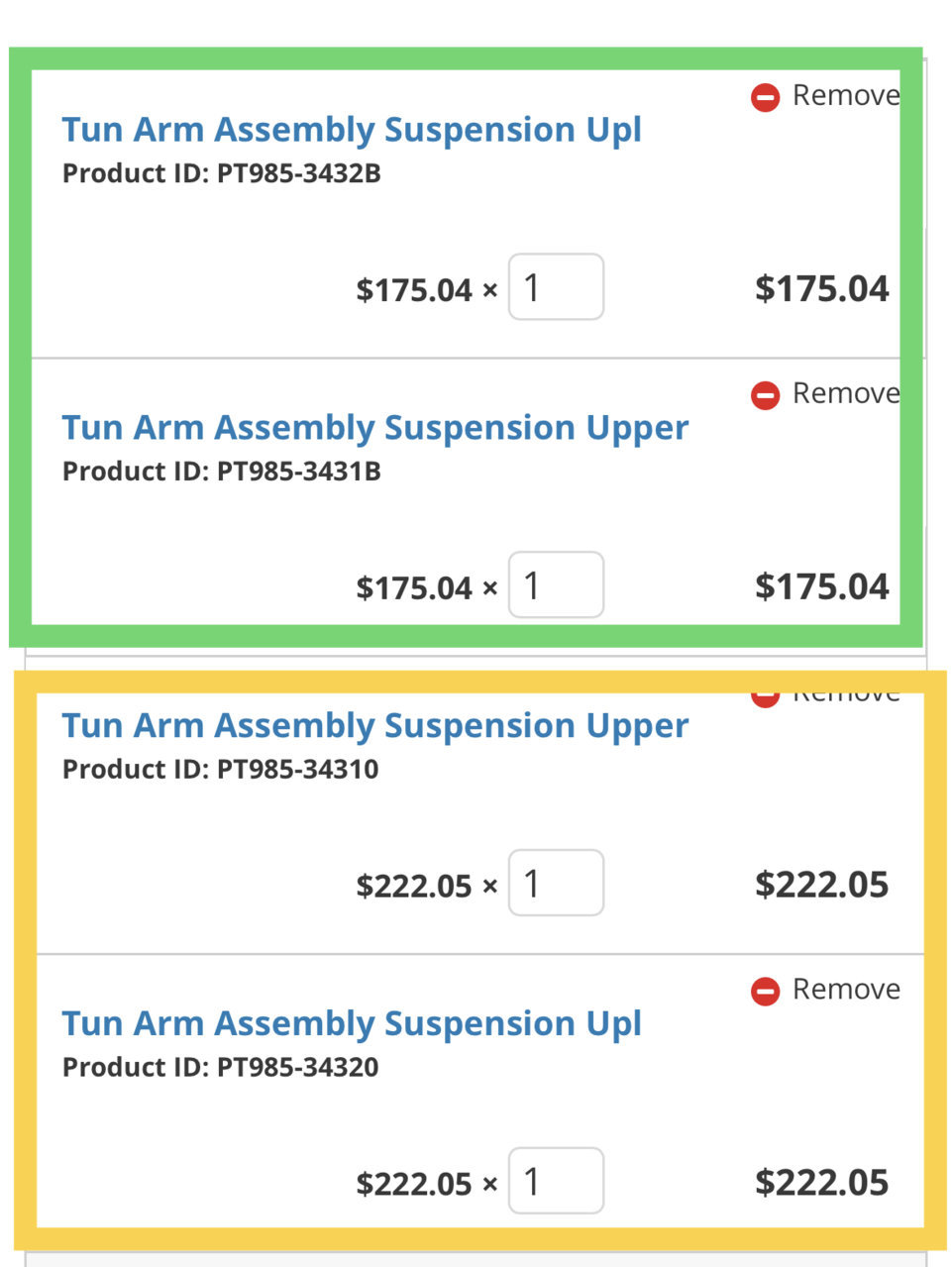

    Called a few dealers they stated the
    PT985-3432B and PT985-3431B are a bulk order part number. So if I order there could be a chance that it could be cancelled
    PT985-34310 and PT985-34320 are the parts available. But price differences are about 80 dollars more for these ones.

    To help clear up the part number issue, here's the info off my receipt for the TRD UCA's from my Toyota dealer
    Part Number
    Part Name
    Price
    Quantity
    Total
    PT985-3432B
    Tun Arm Assembly Suspension Upl
    $192.00
    $192.00
    PT985-3431B
    Tun Arm Assembly Suspension Upper
    $192.00
    $192.00

    Have you tried purchasing online from a dealer and having them shipped to you? I was able to purchase PT985-34310 and PT985-34320 online about a month ago.
