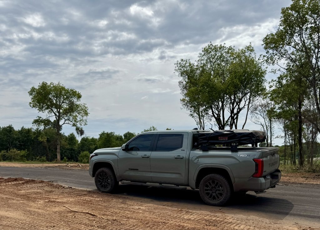

    That’s odd heard only good things about the AT3. Do you have pics of how your car sit right now?

  15. Dec 12, 2024 at 4:56 PM

    Trd pro lift looks good. Heck I might try to fit 35 if I get that kind of lift hahaha.
