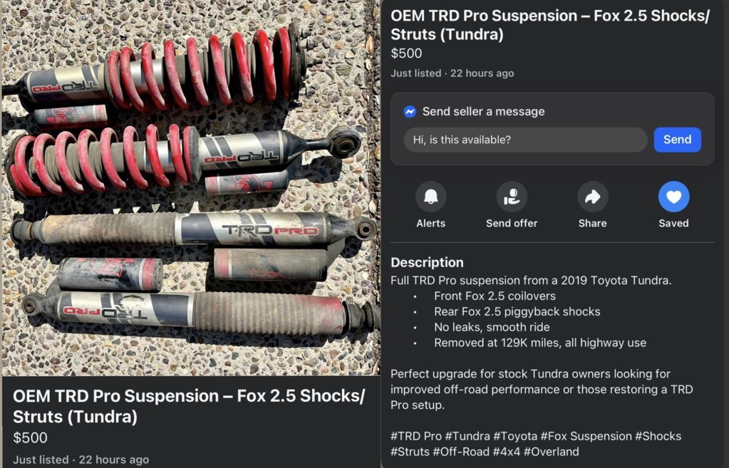

    Hey guys, saw this pop up on the local FB marketplace, is this too good to be true? I feel like normally used Pro shocks are $1,500-2,000, is this a good deal I should jump on or pass? If it is something I should pursue, I feel like I could get these rebuilt and I have a nice suspension upgrade. Let me know your thoughts

    That's probably exceeded the good life of those shocks. Most shocks are good for 75-100k miles on average. Ask him why he replaced them.

    Not a bad price, but I would definitely have them rebuilt prior to installing them... Plan about $200/corner for the rebuild, but even then you'd still be well under $1500 w/rebuilt units :thumbsup:

    I'd pursue them. I just installed a takeoff set of these on my 2018 Platinum (I paid $1200 for a set I was told had 30k miles on them), and I've been very pleased with how these shocks ride.

    I bought a set 1.5 years ago for $850 w/ 6k miles on them. So, deals aren't uncommon. I had them rebuilt anyway, as should you. I used
    https://jtechmotorsport.com/ .
    They are a very, very good shock. I really like them.
    Lots of people replace them vs having downtime to get them rebuilt. Or, they tow a lot.

    Grab them and get them rebuilt. They're probably blown which is why they're so cheap. Being in Socal you have lots of local options for shock tuners too.
