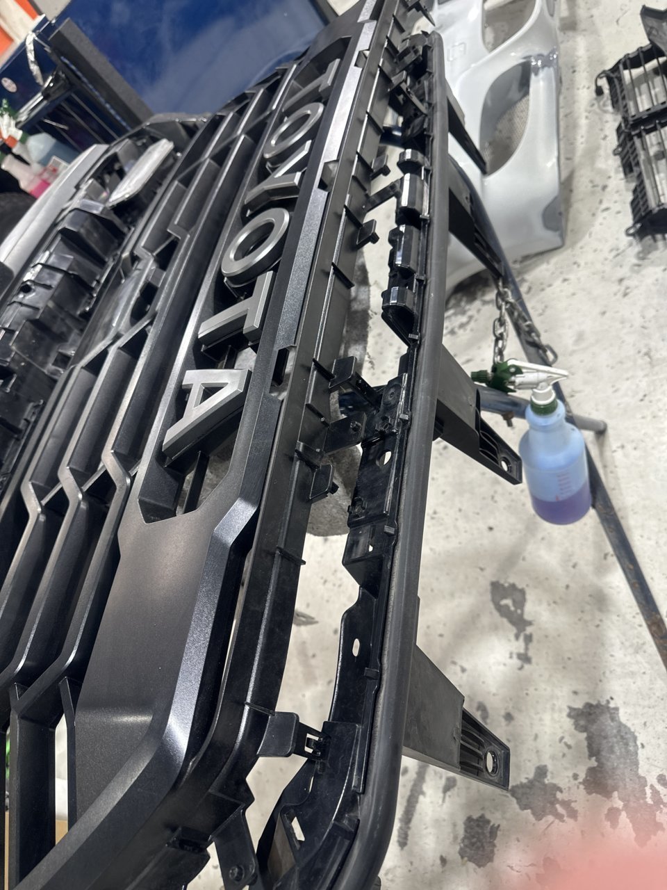

    good lord, so basically take apart the entire truck, lol
    good video!
    I thought you cant paint the smoked chrome and needed to get a bare plastic one to paint?

    plastidip

    caught that later, thanks
    I think color match paint would look a lot better, but its still better than the stock way

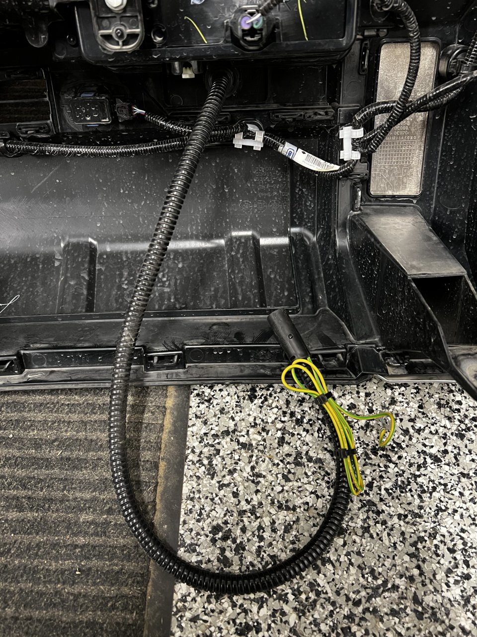

    People with block heaters. You have to open up the passenger wheel well more so you can get to the break in the line where you can unplug and unscrew the ground wire. I had a hell of a time finding this and was pulling the whole cord out before I came across it.
