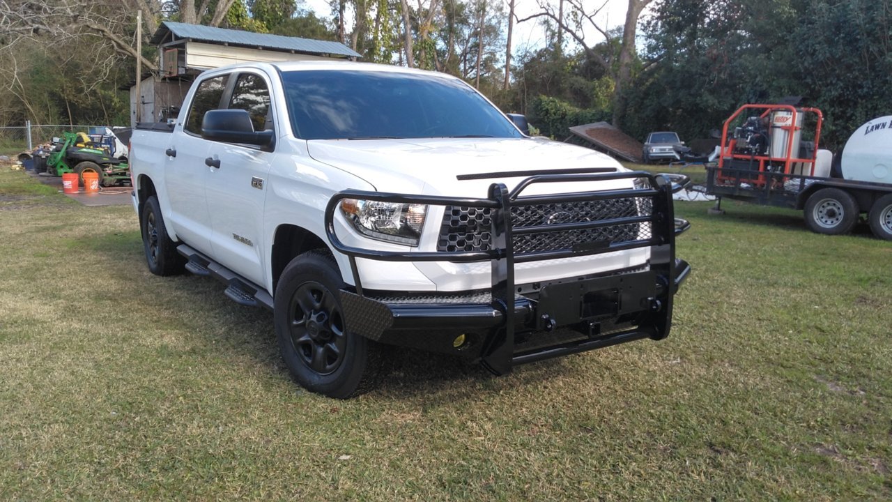

    Awesome thanks so much. I just installed a full winch bumper brush guard and after a couple of days starting getting the clean sensor message.
    This should take care of my issue.
    I have a base sr5 with the sensor in the Toyota emblem of the grill.
    What sensor did you use? Is it for the pro grill?

    I don't know what to do the clearance I have between the bottom of the grill ad the top of my winch is not sufficient i believe.
    Hopefully the manufacturer of the brush guard winch bumper will have a option. I don't even have the winch I installed yet because I'm afraid I'm going to have to return the brush guard..
    Don't know what to do..

    Yeah that looks like it’s going to be extremely tight… You may not be able to do what I did in the video by the looks of that picture, let us know how you make out!
