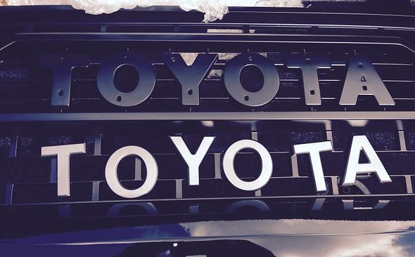

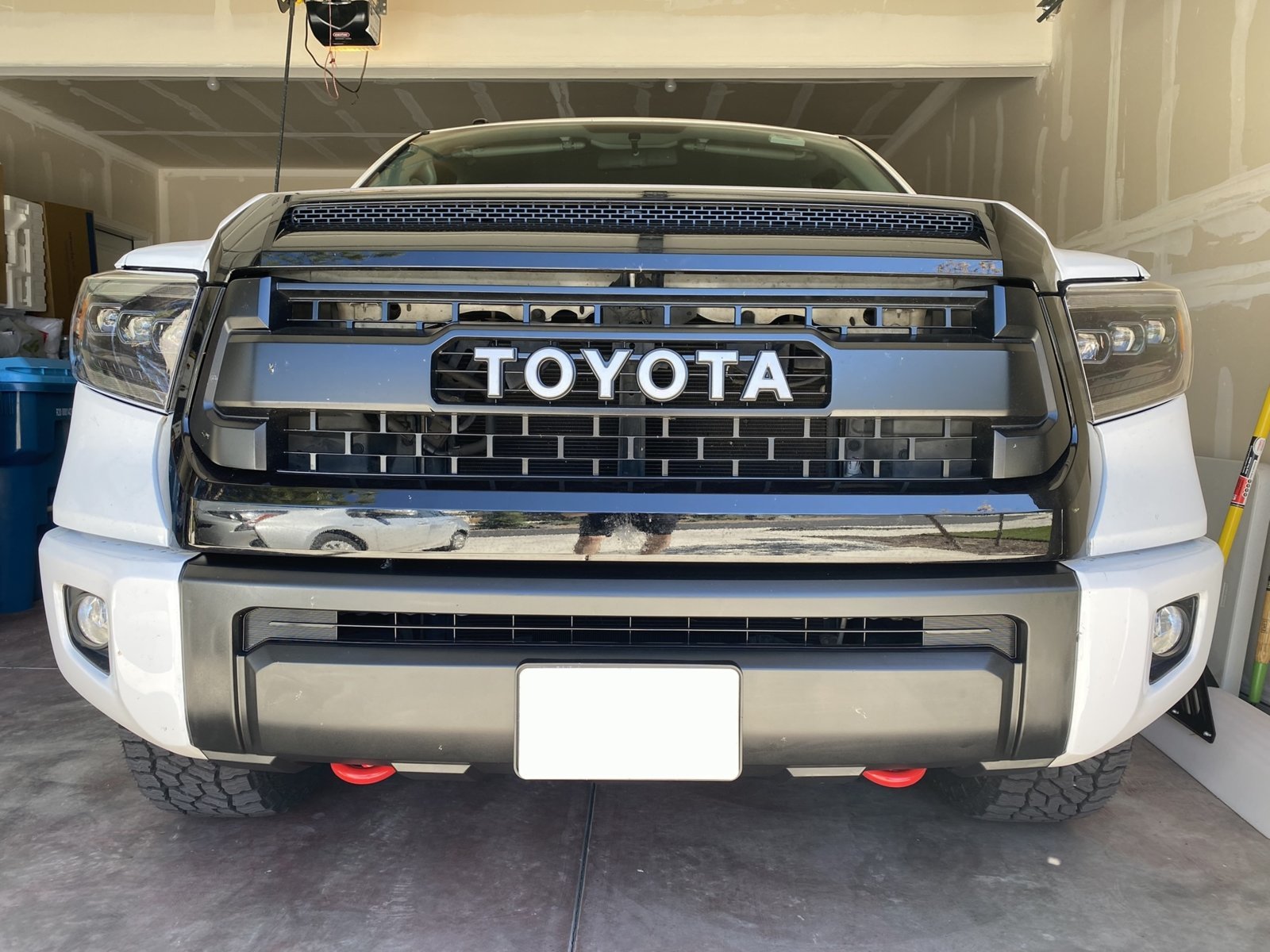

    I had to get my 2014 MGM painted locally in early 2015.
    The TRD Pros didn't come out in MGM until late 2015.
    I pulled the TOYOTA letters and had them painted MGM as well.
    Something to consider @J's 4x4 if you want a perfect match since you probably have to get the surround painted locally anyway...

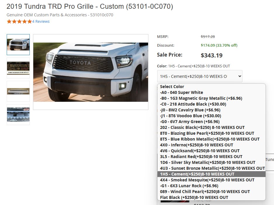

    I gave them that part number, but I guess there's a code at the end for Cement. I actually gave them sparks part and said I was missing the last 3 digits which he couldn't figure out.

    It looks like 1H5 is your paint code.
    But as @ryanwgregg suggested your best bet would be to buy a black or white and have it painted locally.

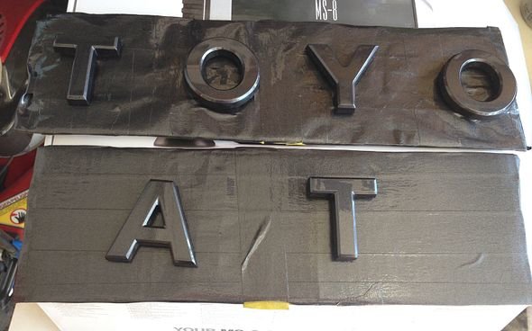

    Were your TOYOTA letters rattle canned or painted professionally? I’m trying to find a DIY solution to make mine semi-glossy black or perhaps a satin black.

    I had to get the surround painted locally and had them paint the letters..

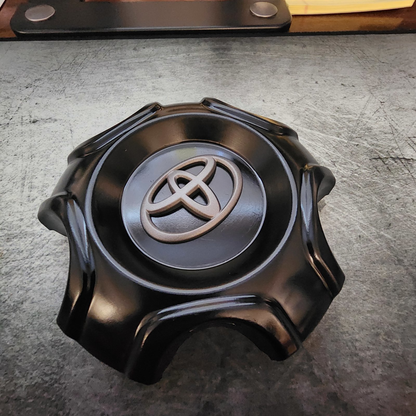

    I had my wheels powder coated a semi gloss black and asked for a can of the spray for my center caps. If you're going for something similar to my wheels...
    This may be what you want...
    https://www.amazon.com/dp/B08XK6NRY2
    I've rattle canned a few other things with it n really like the results :thumbsup:

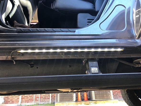

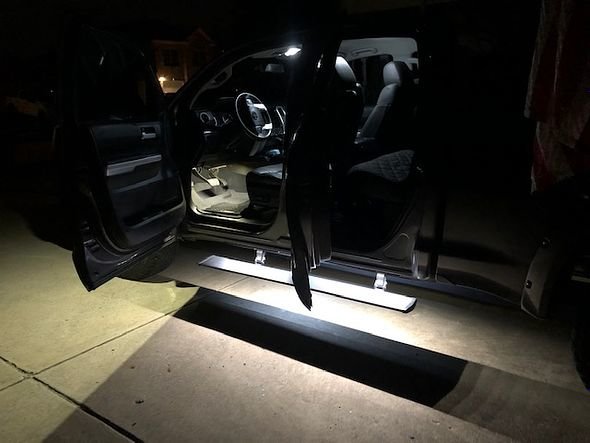

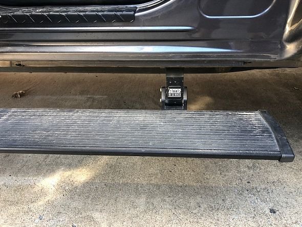

    I will say I did rattle can my aluminum LED light strips when I replaced the cheap AMP step lights.
    I used Exact Match Car Paint Made Easy | AutomotiveTouchup paint and their clearcoat.
    It's held up OK, but if I did better prep and painting it would look better..

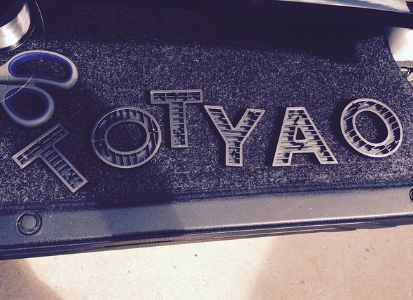

    @1lowlife how tough is it to pull the letters off and re-attach? any tips ... i really excel at breaking sh1t :facepalm:

    I flossed them off using a heavy fishing line.
    I trimmed a bunch of 3M molding tape to reattach, still there after 8 years.
    Amazon.com: 3M Super-Strength Molding Tape, 1/2 in x 15 ft, High Strength Double-Sided Adhesive, Permanently Attaches Side Moldings, Trim and Emblems to Interior and Exterior of Vehicles (03614) : Automotive
    Try not to nick the grille, it's a bit soft..

    Yeah, I actually painted my other set of center caps(not pictured) with that paint and really liked the result. When I get home, i'll snap a picture of them and post up. I think you'll like the outcome if black semi-gloss is what your lookin for.

    Awesome, I appreciate the help! On that note, did you have to do any prep (scuff plastic, plastic adhesion promoter, etc) or apply any sealer over the base coat?

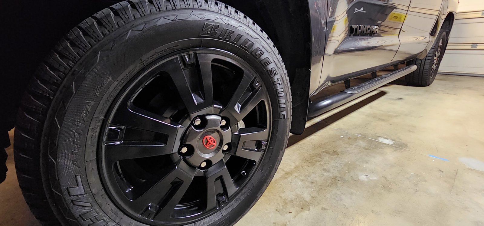

    Here's a shot of one of my other center caps that I hit with that semigloss...
    I didn't really do too much prep on these except for scuff em up a lil bit than wipe off with some alcohol. They are easily removable from the wheel so if I ever do see they need a touch up, I can hit em again with the same paint.

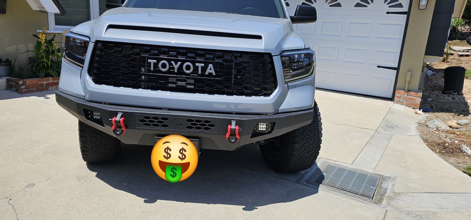

    @J's 4x4 Excellent! So glad that it worked out!
