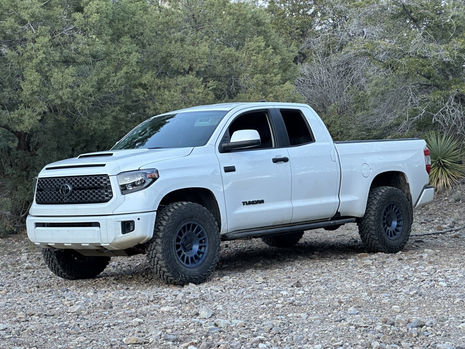

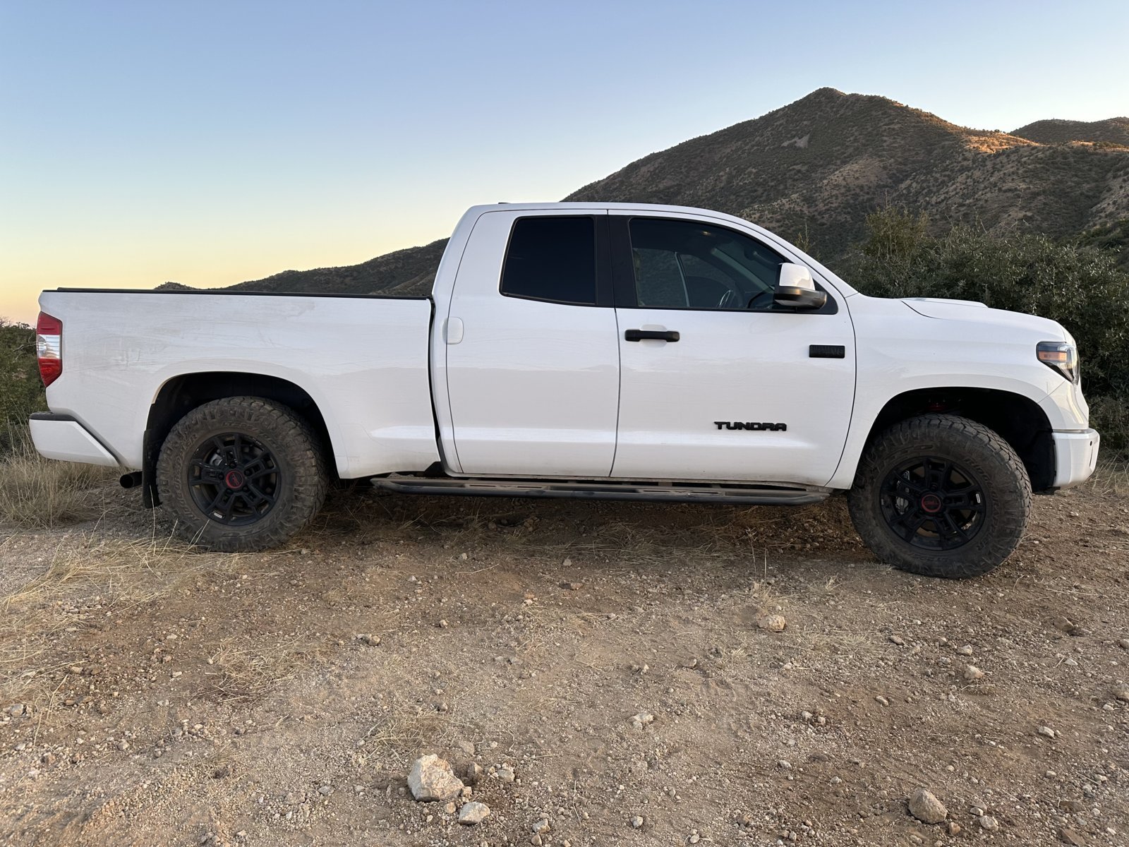

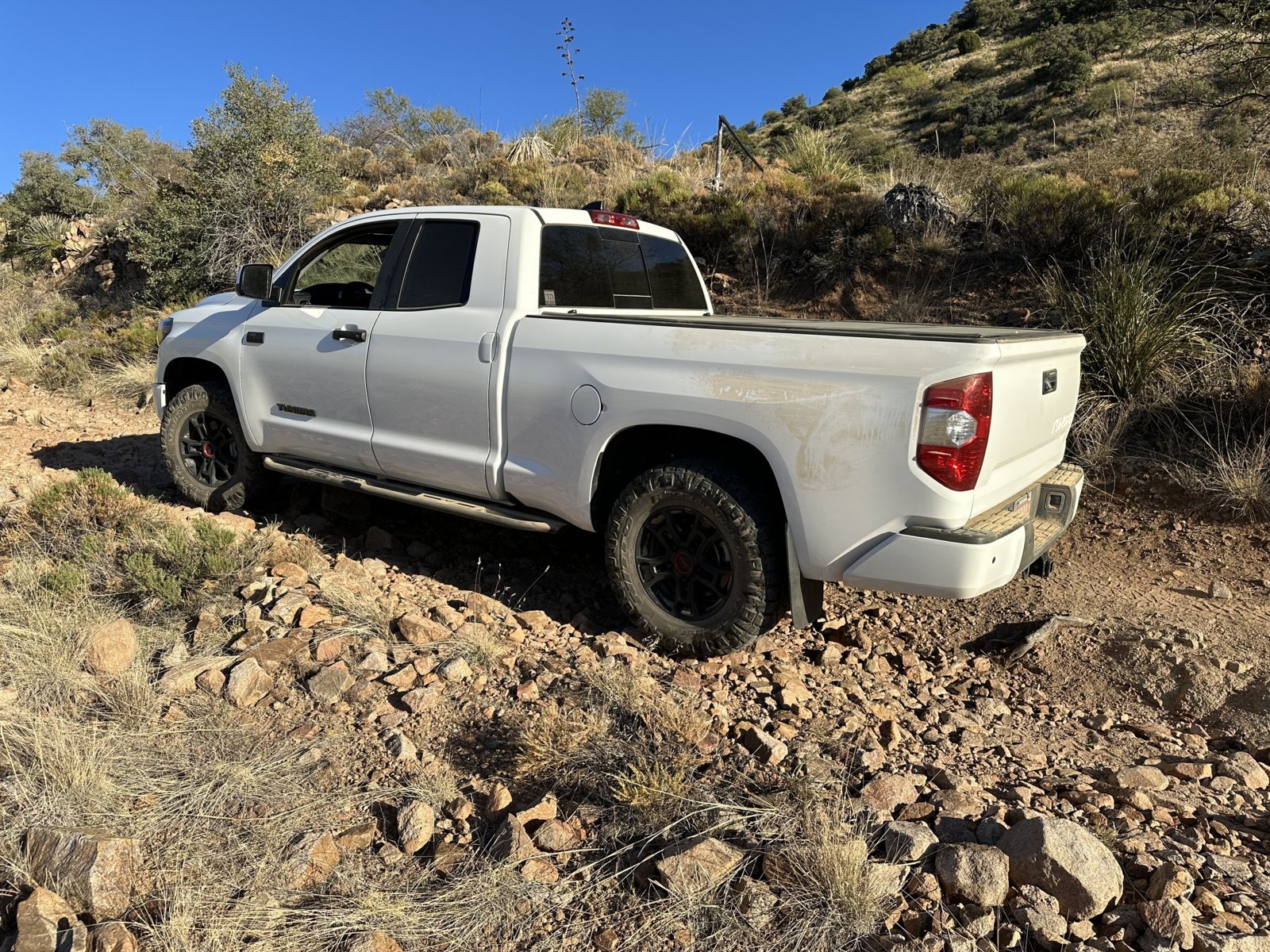

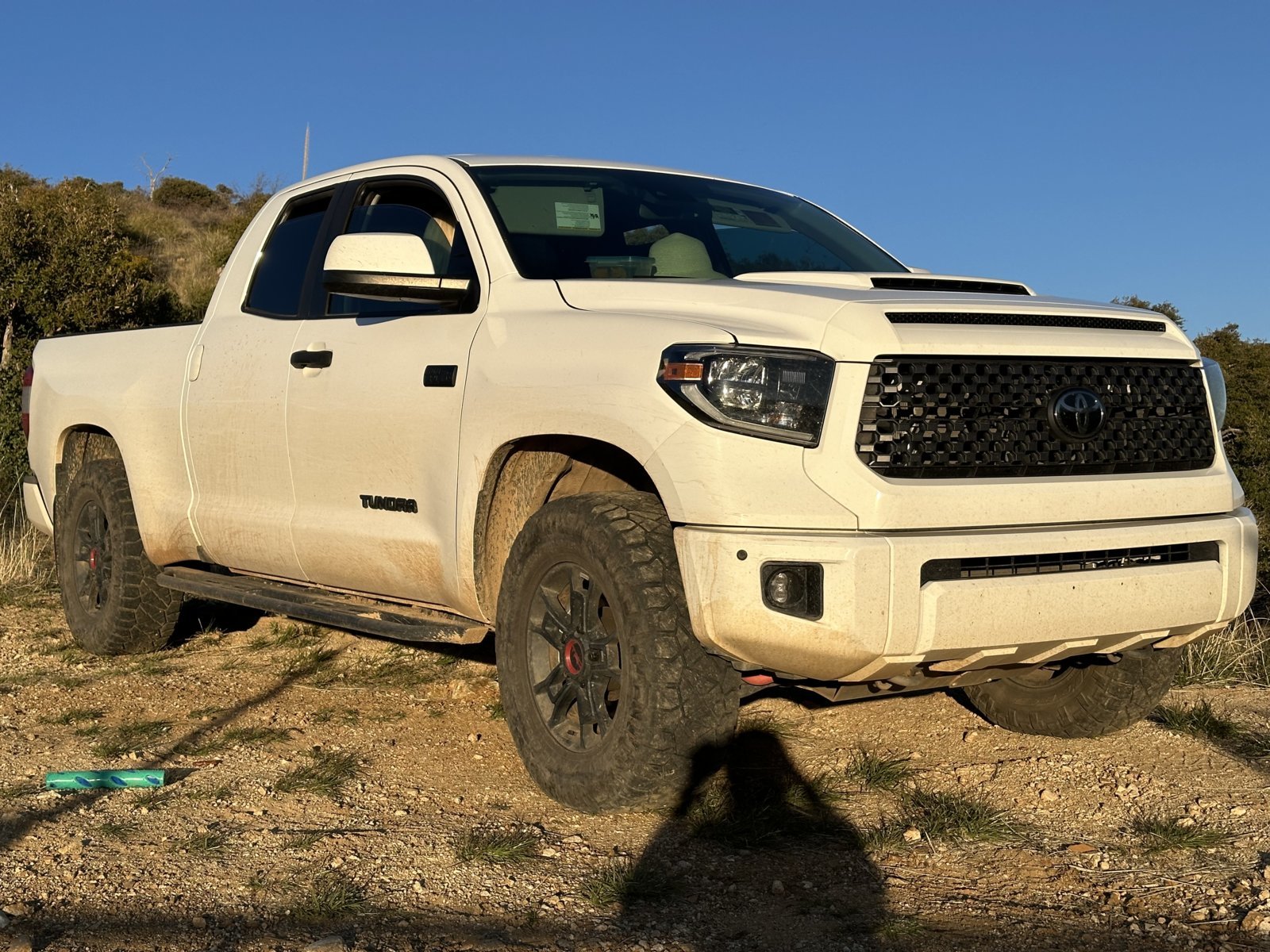

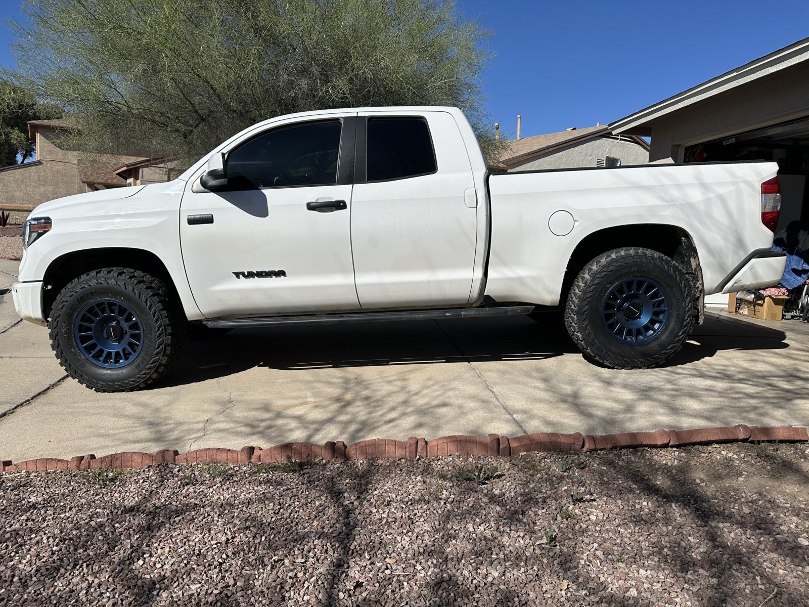

    I gained exactly 1.5" when I added the Fox Trd Pro shocks. The truck looked level, but I had about 1/2" rake on the passenger side, and slightly above 1/4" on the driver side.
    After a few months, I added the Coachbuilder TRD Pro shim for 1" of gain in the front, and the Coachbuilder +3 shackles for a supposed 1.75" lift in the rear. I also added Dirt King/Bilstein UCA'S. I should have about 1.25" of rake now.
    As it sits now-
    With just the TRD Pro shocks-

    Good looking rig man. I’d be happy to go with more lift but I only have so much height at the parking garage for work. Do you have an idea of how high your truck sits?

    I don't, but it fits in my 7ft garage just fine. And, I have the shark fin antenna. Also on basically 36" tires.
    Honestly, I would kind of like to only be 2" in the front and about 1-1.25" in the rear. But, oh well.
