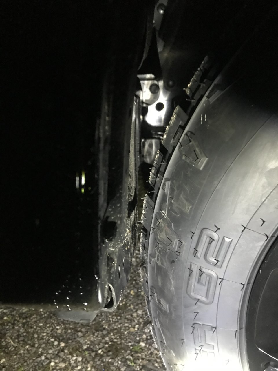

    This is at full turn with 275/60R/20s 20x 9 +20. Removed the flaps and I’m still this close. Time to panic?

    Tight fit but not rubbing.:thumbsup:

    You might get some rubbing when backing up at full turn.

    Yep, you’re right

    Probably need to go down to 275/55R/20s, shit.

    Well that sucks.....Cab mount chop time....???

    Naw, just get a heat gun and a large socket and push the plastic in. I did that on mine. I think there are details in my build thread.

    Wouldn't hurt in case you decide to go bigger later. They're not all that expensive if you're not inclined to DIY.

    I just realized now that OP was talking about removing the small front flap.....lol...oops... now that I look closer.....
  15. Jan 23, 2019 at 5:19 PM
    42,476
    I didn't realize I was seeing the front of the tire.....but a CMC would be nice.

    I honestly just assumed it was the front. I can't really tell if it's the front or back of the well from that pic.

    You can try pushing the front liner forward about a inch on the inside corners. On the bottom of the bumper, where the liner wraps around the bottom of the bumper, there is a bolt - remove this, push the liner forward and drill a new hole for the bolt. I am running a slightly taller and wider tire and this got rid of the rubbing that I had.

    I looks like the front to me now. Isn't that the plastic liner that you can do the heat gun fix to?

    Sorry, it’s dark already. Only seems to contact at full turn when I reverse.

    Nah, metal, plastic has been removed.

    I’m sorry, you’re right. Plastic liner.

    Welcome. Lots of ways to cure the rub.
