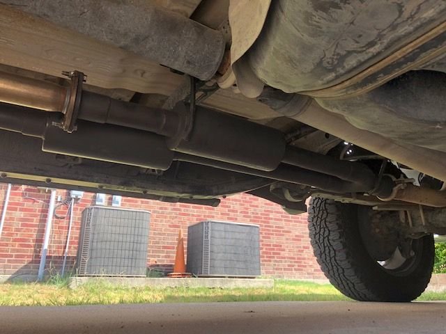

    Gotta be @dirtydeeds for Tundra exhaust upgrades.
    Might be a little over $1k, but Keith does have sales from time to time..
    It's hard to beat Keith's 10" BAM with his Helmholtz resonator.
    I've had an 8", 10", and 12" BAM.
    The 8" will rasp or crackle as you call it.
    The 10" is the sweet spot.
    The startup gives a sweet burp (I use my remote start every time I walk up to the truck) and you can pussyfoot the pedal if you need it stock quiet.
    Of course I give the pedal a little tap under bridges and overpasses just to hear the 5.7 BAM echo.
    The 10" BAM is about the equivalent in loudness to the TRD Pro duals but without the helicopter drone.
    Plus the single-out looks better than the duals IMHO.
    The BAM bolts onto the existing OEM system, replacing the stock muffler.
    First, try it without the resonator.
    If the little bit of drone is noticeable to you (or her), add the res..
    Give Keith a call and see what he can do for you..
