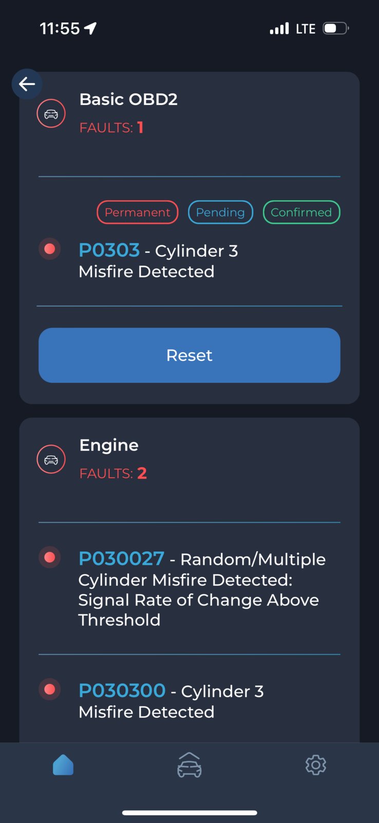

    Welp, looks like my TRD Pro has a nice case of the Christmas lights with 12K on the odometer
    Drove a few short miles to work and felt a weird surge, followed by loss of power. Check engine light, parking brake and hybrid system malfunction- basically in limp mode. I will say that about a week ago I also got the "transmission oil temp high" warning while driving in 4-Low.
    Thought I'd make a thread to catalog my experience so far, in case someone else runs into similar issues.
    02/10/2023- Received "Transmission Oil Temp High" warning light while operating in 4-Low. Code cleared after stopping engine and shifting back into 2WD.
    02/22/2023- Experienced a surge, followed by sudden loss of power and engine misfiring, truck placed in limp mode with multiple warning lights. Drove truck to dealer about 2 miles away.
    02/22/2023- Dealer confirmed transmission warning light. Active/pending DTCs for "Cylinder #3 Misfire" and "Multiple Misfire". Dealer cleared DTC from memory, took test drive. Wants to keep vehicle for a few days to see if DTC develops again.
