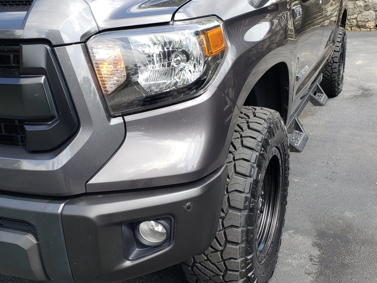

    Here you go. +20 offset, 9 inch wide wheel with 285 tires

    I really appreciate you posting that photo! That looks clean and not too aggressive. Have you done anything since that modification like lifting it?
    Can I bother you for one more photo? Just a side shot to see how the tires/wheel combo look from far away.

    No other mods since putting them on. I actually was not a fan of the poke (it was about an inch and a half more than stock and have since put Toyota TRD wheels on. I am actually selling the Fuels (I have a thread in the Marketplace). I don't suppose you are in the NY/NJ/CT/PA area are you?

    I’m in Florida. Man, I thought 1.5” past the fenders is ok. Now you got me thinking. Did the sides of your truck get dirty quickly due to the road dirt slings?
    Maybe a more aggressive mud-flaps like RokBlokz could help with the dirt slings?
