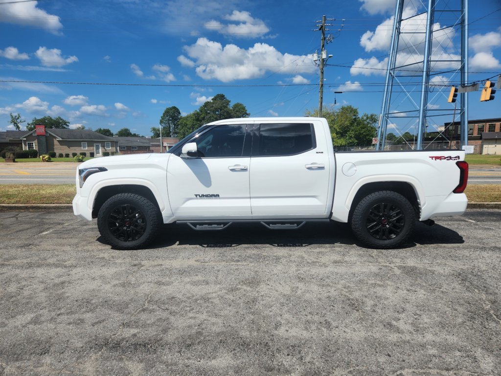

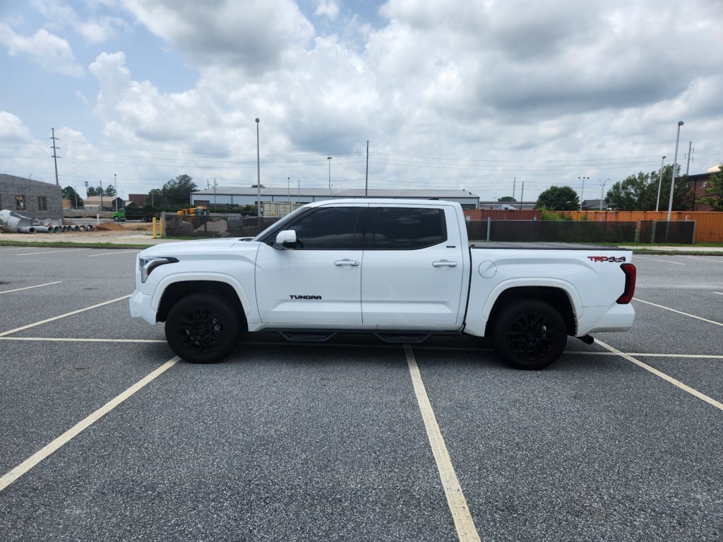

    I'm honestly not sure about the amount of lift because I also did cornfed spacers. I went with the 1" kit and wanted to gain a little rake back so I replaced those with the 1/2" kit when I got tired. I did do an alignment both times. I do have pics of that. I'll post them up in a few.
  20. Sep 13, 2024 at 5:30 AM
    Nomoredomestics
    Nomoredomestics New Member
    Aug 18, 2019
    #34823
    524
    GA
    2023 TRD Sport 4x4
    This is with the offroad struts and 1" cornfed kit.
    this is with the same offroad struts and 1/2" kit

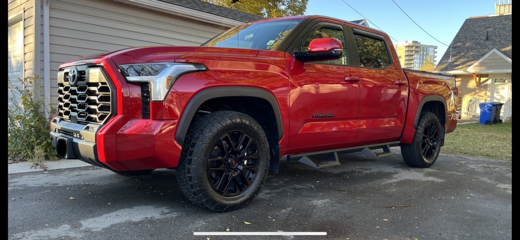

    Ended up doing this, got almost new TRD off-road suspension for $400 cdn, full fronts and back shocks, couple hours in the driveway and done, the ride is exactly what I was looking for, much smoother, definitely less harsh than the stiff sport suspension. Also gained a full inch up front.

    Looks great!
