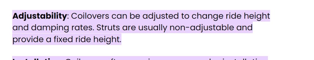

    I'm probably a dumbass.. had that mixed up...always thought coil over meant adjustable...
    https://www.shocksurplus.com/blogs/shocks-101/shocks-vs-struts-vs-coilovers
    https://performance.bilstein.com/en...n (also called,thread on the suspension strut.

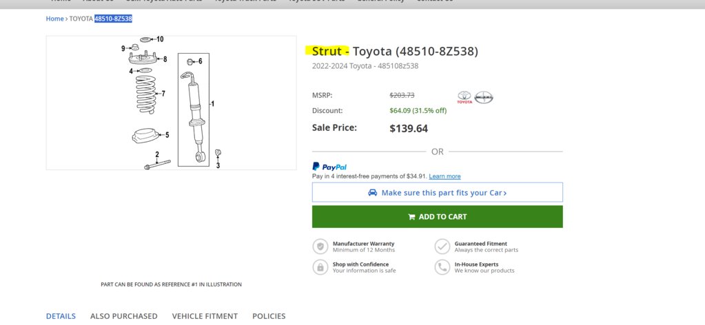

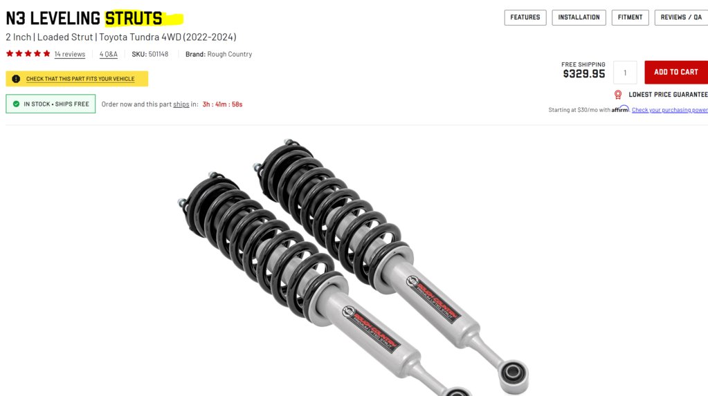

    I know you're not trying to be a jerk, I'm not either. What fun is the the internet without people to disagree with???
    Technically a Macpherson Sturt is a Coil over too because well the coil is over the shock. @blenton looks like most companies are just using the wrong terminology then...

    To me it seems like most companies in the suspension industry only bring "coil overs" into the name equation when they are adjustable and anytime a shock and spring are one unit they are struts no matter what your buddy has said that seems to me to be pretty industry standard to call a spring and shock assembly a strut. When its a Macpherson strut you call it so and when the shock and spring are assembled they are struts and sometimes they are a Macpherson strut. The word Macpherson wouldn't' be needed if you could just say strut.
