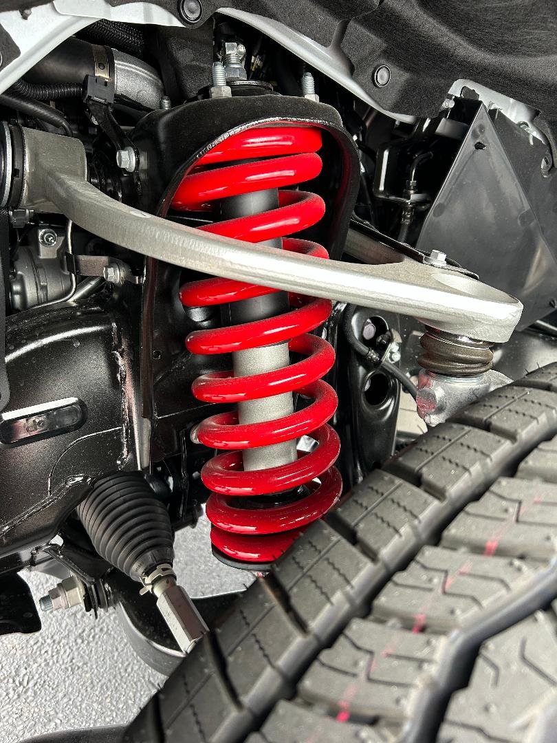

    Do you have the factory 3" lift? I do and it rides like a brick!

    you have the TRD factory lift? or a dealer installed lift?
    I have not heard a single complaint on the OEM TRD Lift especially without 35 load e under them
  20. Feb 29, 2024 at 10:37 AM
    SDHNTR
    SDHNTR New Member
    Jan 20, 2024
    #110534
    306
    Yes, I do, and the ride quality blows. Even with the stock tires. My 2006 Dodge 2500 with E rated tires rode better.

    can you snap a pic or two of the lift parts in the front?
  22. Feb 29, 2024 at 12:31 PM
    SDHNTR
    SDHNTR New Member
    Jan 20, 2024
    #110534
    306
    here ya go.
    Tundrastruck91 likes this.

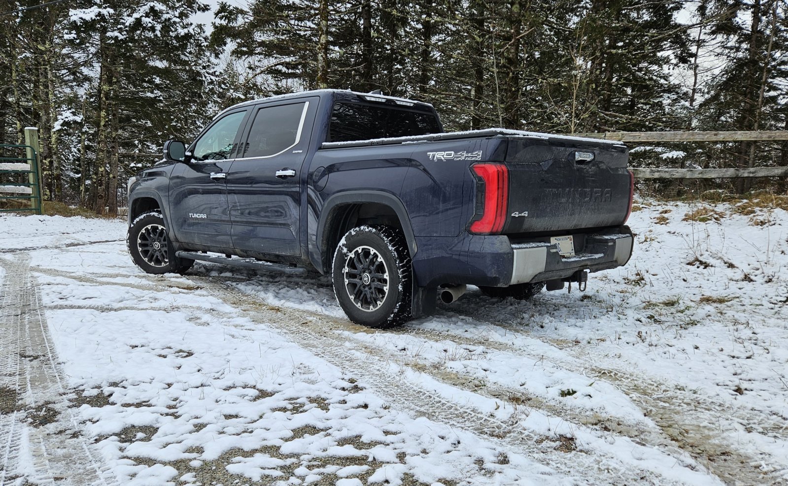

    No lift here. OEM OR suspension with red Bilstein shocks. Yeah, I know, it's filthy in this pic... It's winter and it still had a bunch of undercoating overspray too.20240101_1056121.jpg
