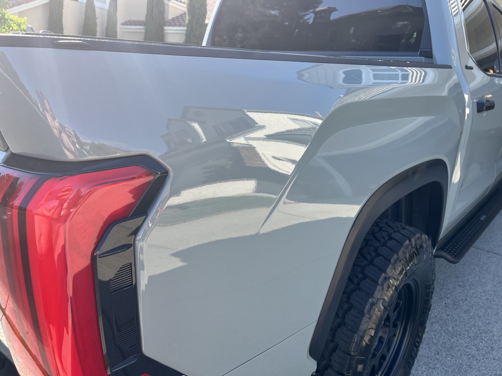

    That’s what I thought I would be able to do for mine and it ended up being more involved for me. I heated and peeled it off, but it separated into two layers and only the top layer peeled off. Second layer was solid silver in the full shape of the original sticker. I could not get it to peel off for the life of me.
    I ended up getting a decal removal rubber wheel to get it off and then polished and buffed it out.
    happy with the result but it was more work than I planned.
