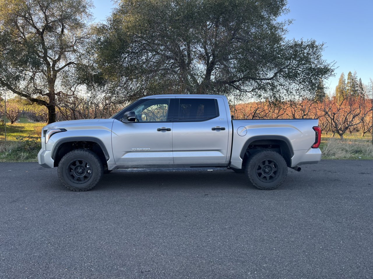

    F971B708-902C-4CD5-AE6D-B0B9ABB15463.jpg 933F300A-D7CE-4EE5-8A7B-B9684CAA334D.jpg You
    this is my truck with 285/70/17's with the TRD lift. I have the tires from my other truck so I kept that size. I like the look of 35's but I'm fine with this setup. Slightly less loss off the line too. Hope this helps in your decision making process. I don't park in the garage so height wasn't really a factor for me.

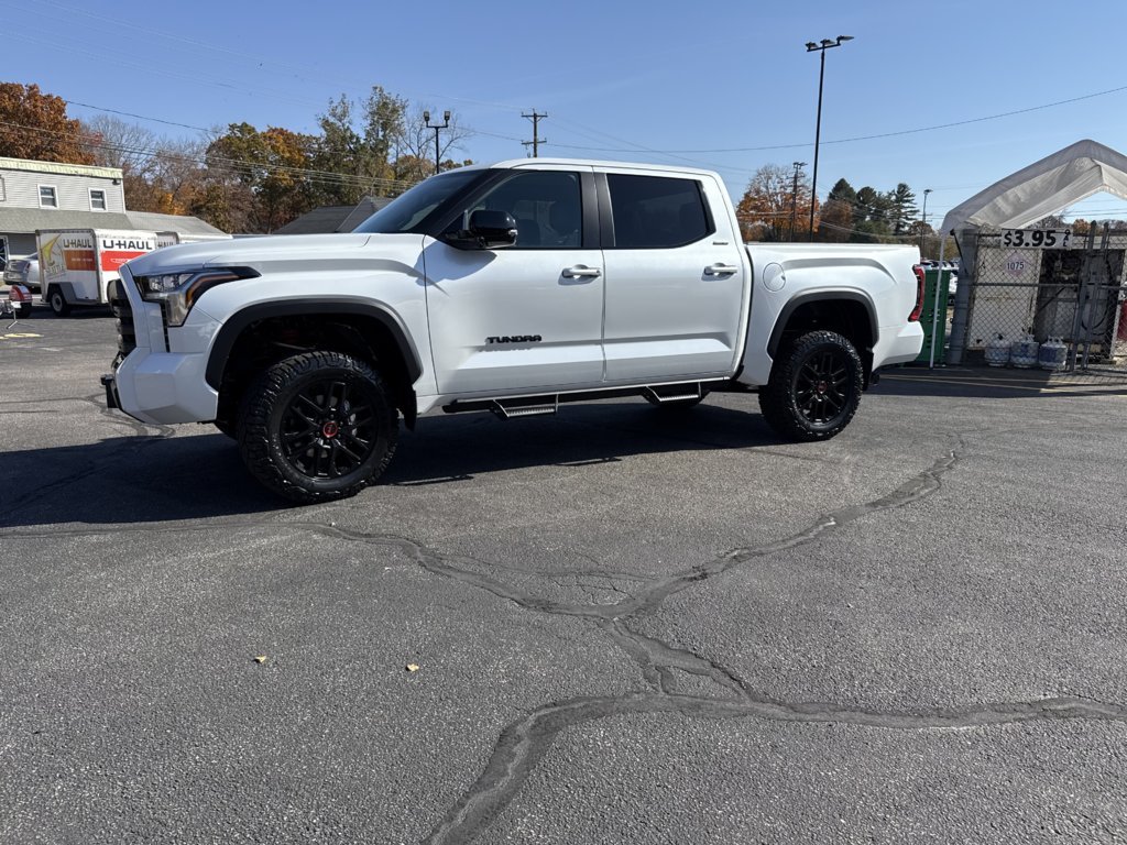

    I have a 2024 limited with the factory trd lift kit. I had the dealer put on goodyear duratrac RT 285/60/20 tires and they fit perfect, very quiet and look great.. They also fit in a standard garage with no problem

    We did another tundra with the same lift but with nitro grapplers but they were not the best in rain. The Goodyear I love. Here is the other one . From my knowledge the max tire size you can go with on the factory 3 in lift would be 285/65/20 ( factory trd 20 in wheels ) anything larger then this and you will rub..

    Your pics look really good. Thanks for posting. Maybe I’ll see if I can find a tire dealer to try the 285/65/20’s on the front to see if there’s any rub against the sway bar. Or, try spacers. Thanks again!
