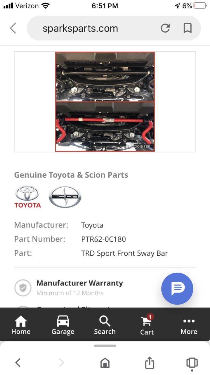

    I’m online myself looking for one. This is the part number from sparks Toyota. You can Google the part number and they range in price from $180 to $220.

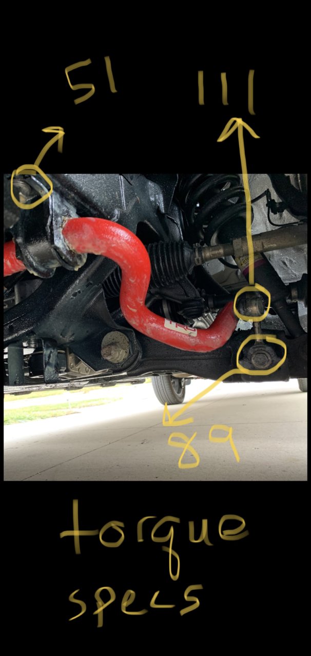

    That's the right one. Just an FYI it was very easy to do mine on my 2020 since it was brand new, but we had a hell of a time getting the torque nuts off of the sway bar end links on my dads 2016. We were almost to the point of giving up and ordering new ones, but luckily we got them off. They are 125-185 a piece lol. If you use the impact on the end link and it's just spinning in the joint, take the correct size allen wrench and put it in the end of the bolt while turning the nut with a wrench. I would start spraying them daily with pb blaster and hopefully that will get them loosened up when you go to put them on.

    I have a 2017 and can only find them for the 2018+. What the hell am i doing wrong?

    That part works fine on the 2017. My
    That part works fine for the 2017. We installed it on my dad's and his is a 2016.

    Ok. I guess Ill order it now. Thanks Ed. Im from OH-IO too, just live in FL now. I was reluctant to order it when it said it didnt fit on my truck. Ill get on that PB Blaster now too. Can you show me exactly where I should be spraying it? Thanks!

    Spray the sway bar end links. They attach to the ends of the sway bar. I'm originally from pa. Moved to Ohio for college and just kinda stuck around haha.

    Spray on the nut where i circled the 111 lb-ft torque spec on the insides.

    Hey also 2 things to note. If you haven't taken the skid plate off, once you get the 5 bolts and 3 screws off, push it up and towards the driver's side to get it off. And before putting the new sway bar on. Torque the bolts labeled 111 ft lbs to spec before putting back onto the vehicle as you won't have any room to torque them once the sway bar is back on the vehicle.

    It should be the same sway bar for the 14+, I’ve owned a 14 and currently own a 17, and 18. The suspension hasn’t changed. You can always call a dealer and find out for sure about the part numbers. Question, could it be possible that the front sway bar didn’t come out until the 2018 TRD Sport Package so that’s why it’s labeled that way? The rear has been available since 2015 for sure because that’s when I installed it on my 2014. I’m not sure what year the front came out.

    The posted bar is also ok for a 2010. I have one (not on yet)

    This ^^^ is mission critical. 111 lb-ft. ONE HUNDRED AND ELEVEN. Huuuuuuge torque

    This Sway Bar is also correct for the 2007 - 2019 Tundra's Yay! have one on order for my 07
