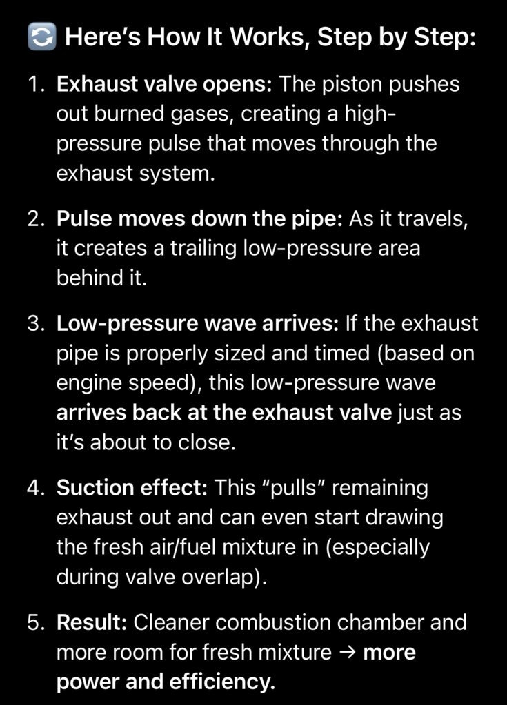

    I've heard this on the forum but the dyno numbers don't really show a loss of low end torque. So not too sure if it's made up or I'm the one who doesn't understand. Either way I just thought it was interesting you actually gain torque and HP, I always thought it was just for sound and no gains.
