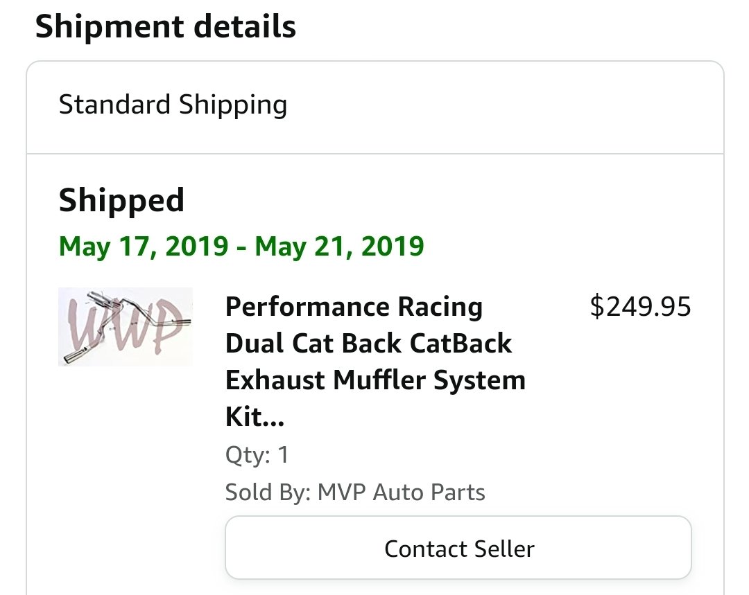

    Not seeing any listed but this was my order detail. Keep an eye out for that company.
