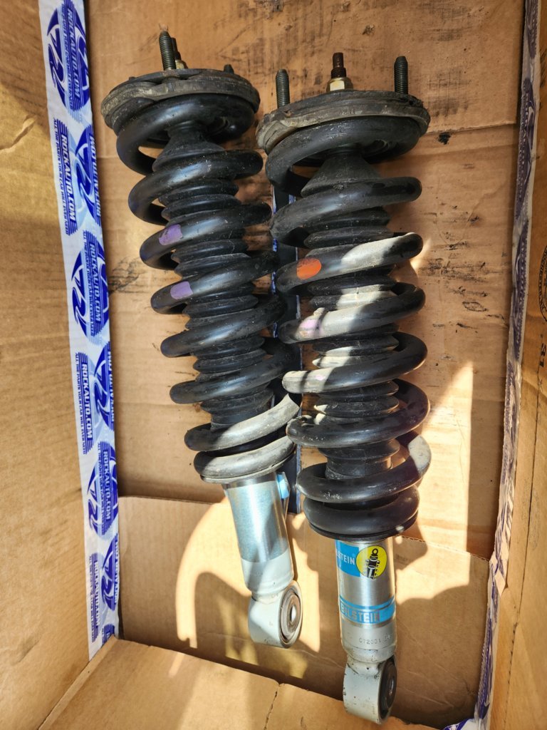

    This is from my trd 04 DC 4x4. I'm not sure what you'd call this color. Red and pink?

  7. Aug 19, 2023 at 7:23 PM
    NickB_01TRD
    Jun 16, 2021
    #64346
    2,674
    Nick
    KY
    01 Tundra V8 4X4 AC SR5 TRD
    Take a pic of that whole strut top to bottom. Those may be from another generation truck.

    Turns out the struts where from a different generation. 2011 tundra.
