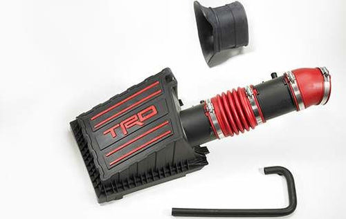

    I'm trying to figure out how to get more air into my 2016 TRD Pro's 5.7L engine because both of my banks are running too rich, which throws the check engine light and disables my traction control.
    I think I've decided on one option, but I need some advice from those that have experience with the Toyota TRD airbox before throwing hundreds of dollars in this option without it working and having to return it.
    I'm thinking I can save money by just buying the top part of a TRD airbox from a 2012 Tundra, which has a handy air flow restriction gauge on it, and mounting it on the lower half of my stock airbox on my 2016.
    For some reason, Toyota list the 2012 and 2016 TRD airbox as different and incompatible for reasons they won't explain, but I'm thinking it could be because the deleted the air flow gauge on it to make more profit on it.
    I know the 2012 uses the same air filter as the 2016, so I'm thinking this should work.
    Am I wrong?
    (Please, don't tell me this and that about other air boxes here.)

    The lower air box changed from 2007-13 to 2014-21. The 2.5 generation is smaller overall size. The top air lids aren’t interchangeable as a result.

    Unless you have a tune or power adder, the air box is not causing the rich issue.

    Old one has 4 clips and the newer box only has 2

    This. An airbox lid isn’t going to fix a rich bank condition. I have trucks with both airbox sizes - the 14+ is smaller than the 07-13 and doesn’t fit.
    Magnusson… meaning your truck is supercharged? That’s some relevant info. Check out the General Supercharger thread but a custom tune is a great idea. @JustDSM and @snivilous are both great tuners here on the site. But your issue is likely mechanical and needs to be sorted out before a tune, but maybe not.
    Do you have any CEL’s associated with it running rich? A good diagnostic technician and code reader could tell you a lot.

    Dude you gotta list a LOT more information than drip feeding us what is done to your truck if you want decent help.
    If your truck is supercharged with a Magnuson it most likely has oversized injectors. It SHOULD have a dedicated air box from Magnuson which appears factory but can be verified by measuring the MAF area diameter at ~4" for the Magnuson box and ~3.5" for a stock box. The truck SHOULD have a tune from Magnuson or someone else.
    If you have a stock air box and a Magnuson tune, then the truck thinks it's flowing a lot more air than it is in reality so that's why it's running rich, it's compensating for what it thinks is the airflow of the big airbox.
    The bigger air box and injectors are not strictly required, the truck can be tuned with any air box and injector combination. But the tune that Magnuson provides (if the truck has it) is meant for the green injectors and the 4" air box.
    What air box, injectors, and tune do you currently have?
