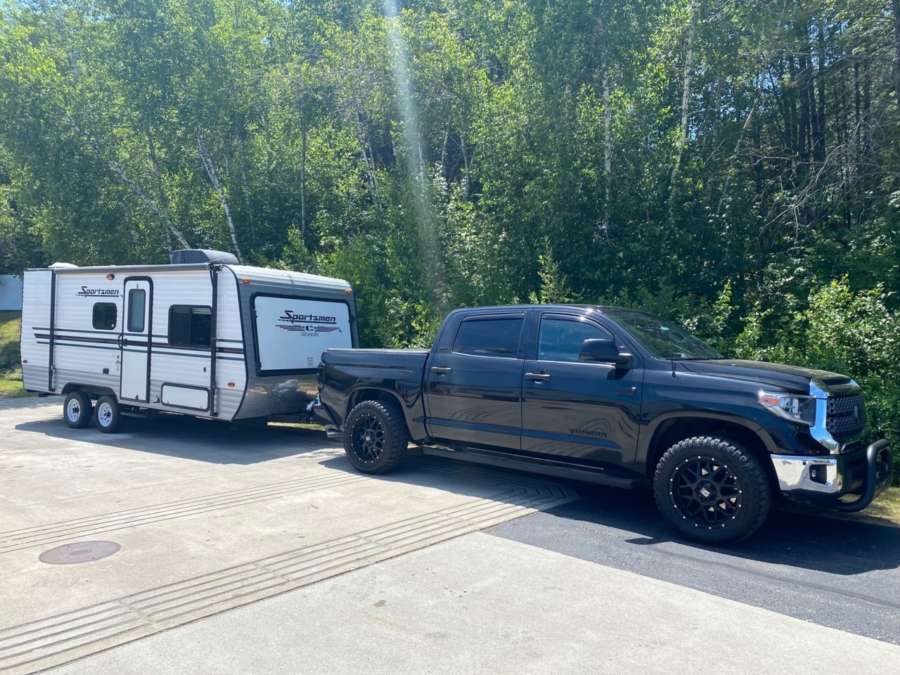

    @8post96, if you do a quick google search. It sates "When properly equipped with the available 5.7L V8, Tundra can tow over 10,000 lbs. 1 and haul more than 2,000 lbs."
    I have a Sportsman 20' travel trailer (very light - I think its 4500#'s unloaded). The tundra pulls it with ease

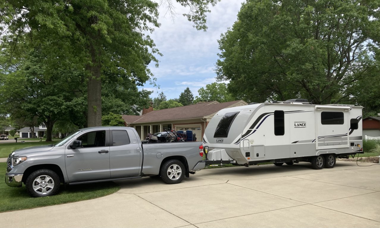

    D8C16992-076E-4CE1-9848-0B501CA30936.jpg I pull a Lance 2285 with blue Sumo Springs in the rear of my 2wd, 5.7L and an Equalizer WDH. 650# tongue weight, probably close to 7,000# fully loaded. I would not recommend anything over 8,000# total. Rated to pull 10,000# but the 80% rule is a very good rule to follow. 10,000# requires a 3/4 or 1 ton truck imo.
