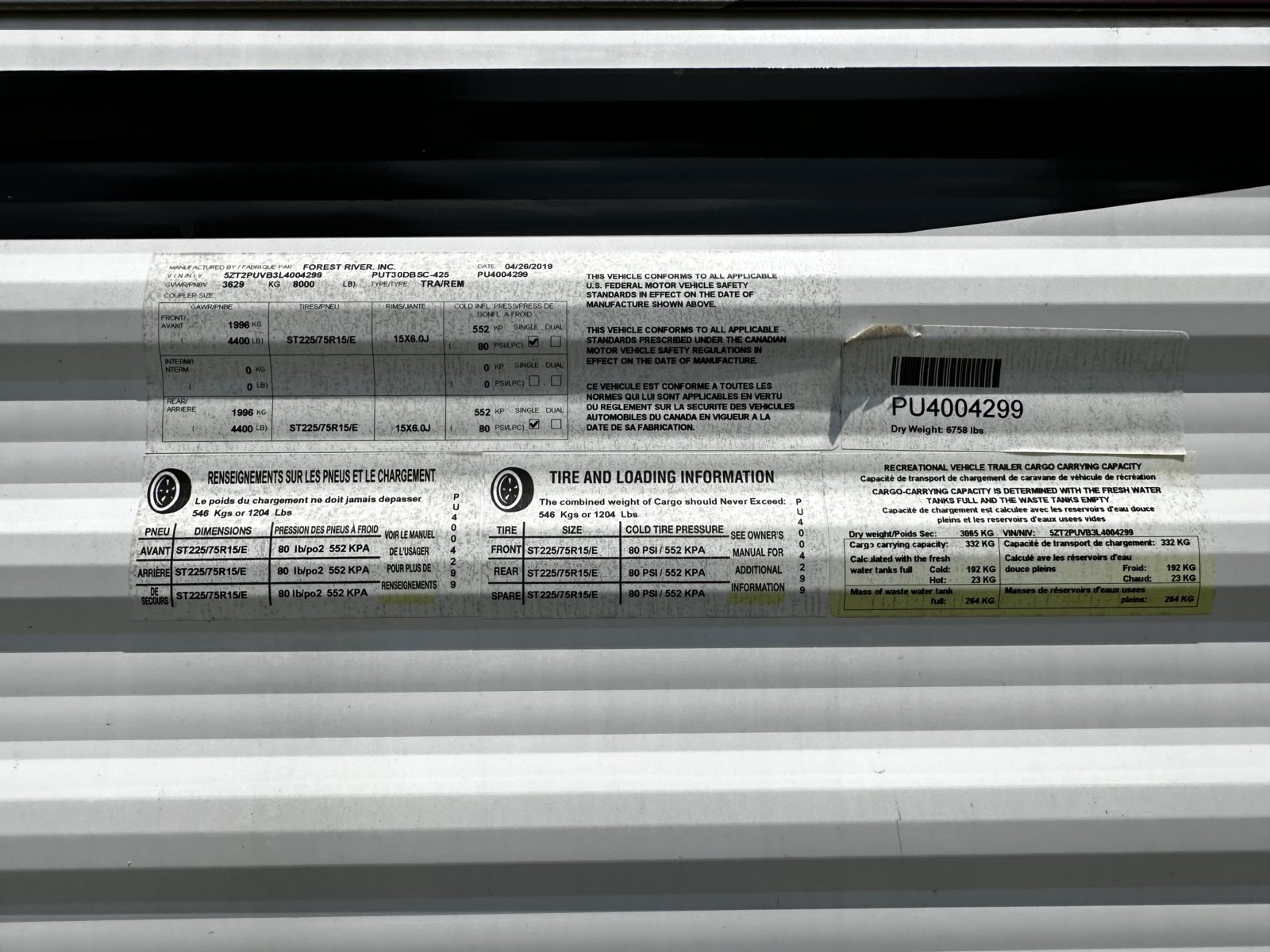

    Our travel trailer sticker shows 80 PSI as the set point for the 8K GVWR listed.
    Each tire of the 4 shows max 2800 lbs. at 80 PSI. Does this mean that I’m supposed to have the trailer tires set at the max 80 PSI? Seems too much.. have it at 60 PSI currently

    80psi as listed by manufacturer. Trailer tires are typically run at high pressures (often max listed on sidewall) to handle the loads they encounter. Seems normal to me.
    Even those little utility trailer tires, 13 inchers typically need 50psi per trailer manufacturers. Use the PSI they recommend, going too low on a loaded trailer impacts handling, makes the tires heat to much and they can blowout.

    In your case I'd say yes.
    Underinflated tires create heat that in turn compromises the integrity of the tire.
    2,800 lbs. X 4 = your 8K lb. GVWR plus a little buffer.
    You can probably find the tire mfg's Load/Inflation table and see what it says but you want some buffer.
    My trailer came with 50 psi max OEM tires which I ran @ 50 psi cold. When they aged out I replaced them with C range Goodyears one size bigger which are 65 psi max cold inflation.
    Since my trailer didn't get any heavier I don't need that much load carrying capacity. I found the Goodyear endurance load chart.
    I run them at 55 psi. which is more than enough. In my case, max inflation with the Goodyears would be needlessly harsh.

    Agree with the fella above. Look up the load chart for your tires to see what air pressure is recommended.
    In my case, I went to LRE Goodyear Endurance tires to replace the OEM LRD China-Bombs my trailer came with. Max inflation on new tires is 80#. That’s to carry the max load they can handle.
    I’m well under max, and run 65#. They do not run hot (this is monitored via my TPMS system) and track beautifully. Tows like a whole different trailer.

    "ST" tires or 'specialty trailer tires' are meant to be run at max air pressure. So, based on your trailer's placard, you should have ST tires on the trailer... IE>> ST225/75/15, etc.. and not a P225/75/15 or an LT225/75/15.
    Because of the design of the ST tires, if they are run below max PSI you risk overheating them depending on the load, vehicle speed, weather and road temp conditions, etc.... Softer sidewalls (less PSI) generate more heat as the tire rolls down the road due to extra flexing from a 'mushier' sidewall and increased rolling resistance (friction).

    Another angle to consider; my OEM tires were ST205/75-15 LRD. Max pressure was 65#. At full inflation, they were soft and squishy with my load. I bumped up to a ST225/75-15 LRE. Max pressure is 80#.
    Looking at a load chart, my new tires have more load carrying capacity at 65# (81% max pressure) than my OEM did at the same pressure (100% max pressure). The new tires are rock solid with my load, and bumping the pressure up made no appreciable difference in feel or temperature, as monitored via my TireMinder i10 TPMS system. All it did by running max pressure is likely reduce my contact area on the road, which would decrease grip in braking.
    Will max pressure hurt? Probably not a lot. Is it necessary when carrying less than max load capacity? Nope. Not even a little bit.

    I've always heard to defer to the side plate rating, not the tire max because the tire will probably carry more than the trailer weight. Ran my Goodyear Endurance at the 65# recommended on the camper's sideplate, not the 80# max on the tire and they worked just fine. Helped the gas mileage too. Running them at 80# would probably rip the hinges off the cabinet doors.
