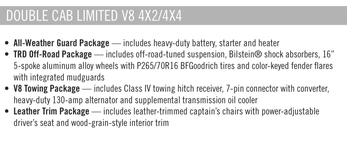

    This is what came with my 04 DC LTD.
    Your 01 pkg might be different but you could check your yr Brochure in the sticky threads.4D30BB66-BA4F-4595-9367-C690278332FD.jpg

    Looks like I have a trans cooler and 100amp alternator but did not have hitch.

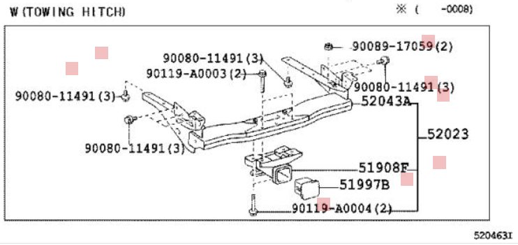

    My local dealership (if I order through parts.toyota.com) sells the entire hitch subframe assembly with receiver and plug (part number 520230C041) for $1100. It includes all this (NOTE: Toyota's parts system says this only fits '02+ trucks):

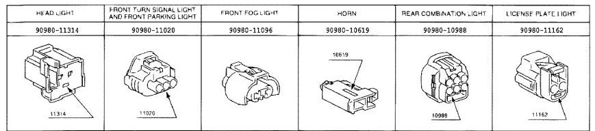

    It's not one of these, is it?
  19. Jul 27, 2022 at 1:43 PM
    daveeasa
    Dec 2, 2020
    #55605
    4,181
    David
    10988 might be the final 6. It’s the same as the taillight connectors as far as I could tell. The 11 position isn’t in there.
