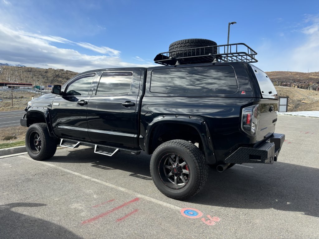

    I am new here to the group, thanks for the add. I am also new to my new to me tundra. I love the truck and I got jumped into the club early on. I picked it up 10/31 and 11/24 the transmitter left the chat on the way to California. Looking for some others expertise with rebuilds, factory replacement custom build?
