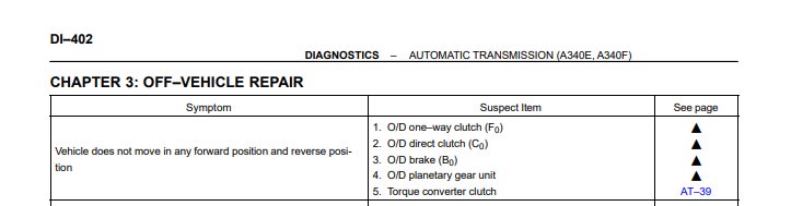

    You'll need to download a copy of the Field Service Manual and follow the diagnostic flow chart starting on page 1368
    One of these is most likely your culprit
