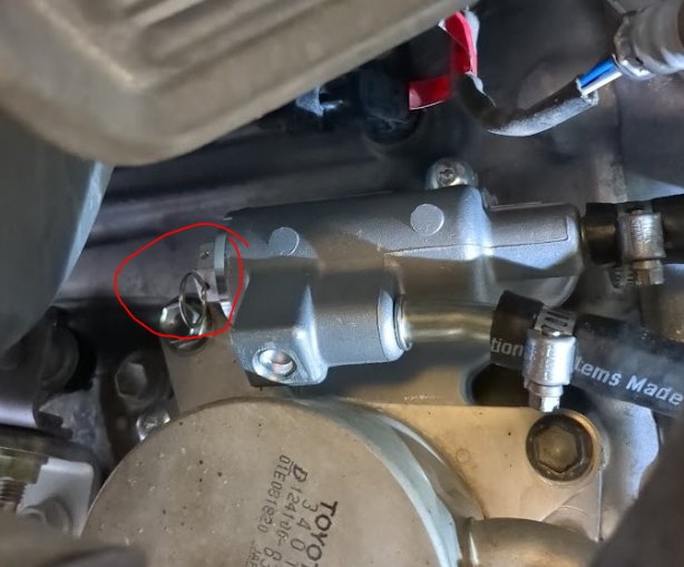

    It's under the truck, on the passenger side behind the front tire. There will be a big hockey puck sized thing coming off the transmission, above that is the thermostat. On the back side there is a little plunger that you push in with a screw driver, and then slide a wire/pin through both holes and it will keep the plunger depressed.
    The thermostat opens when the transmission gets hot, but it doesn't seem to FULLY open so you actually end up with quite a bit more cooling in my experience with it pinned open. In the winter time, myself and many others keep it pinned open, the transmission still gets up to temp within a couple miles.

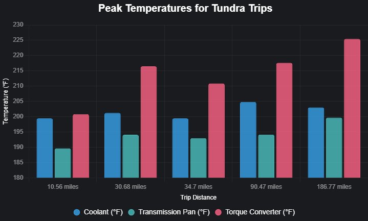

    Appreciate the all the replies and info. I've never towed with this truck and highest pan temp i've seen is 199F. Highest torque converter temp i've seen is 225F. This was gunning it hard up a long hill. After cresting the pan dropped to back to 194-196F then even lower down 188-190 going back downhill. Sometimes around town i'll see the torque converter spike to 215-218F always goes down when locking up. I used Grok to make a chart for my recent trips. How do these numbers look? Thanks gang!

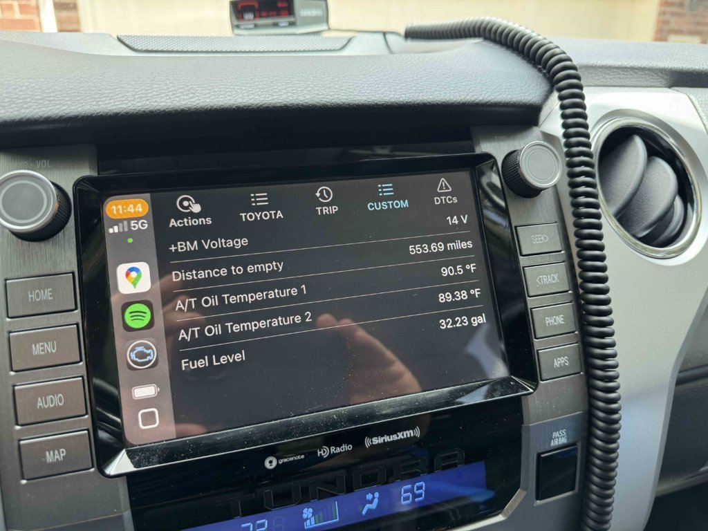

    I see mid 180s to mid-190s on my 2008 (stock size tires, 5.7 with towing package) with regular driving. The picture shows the OBD Fusion app running.

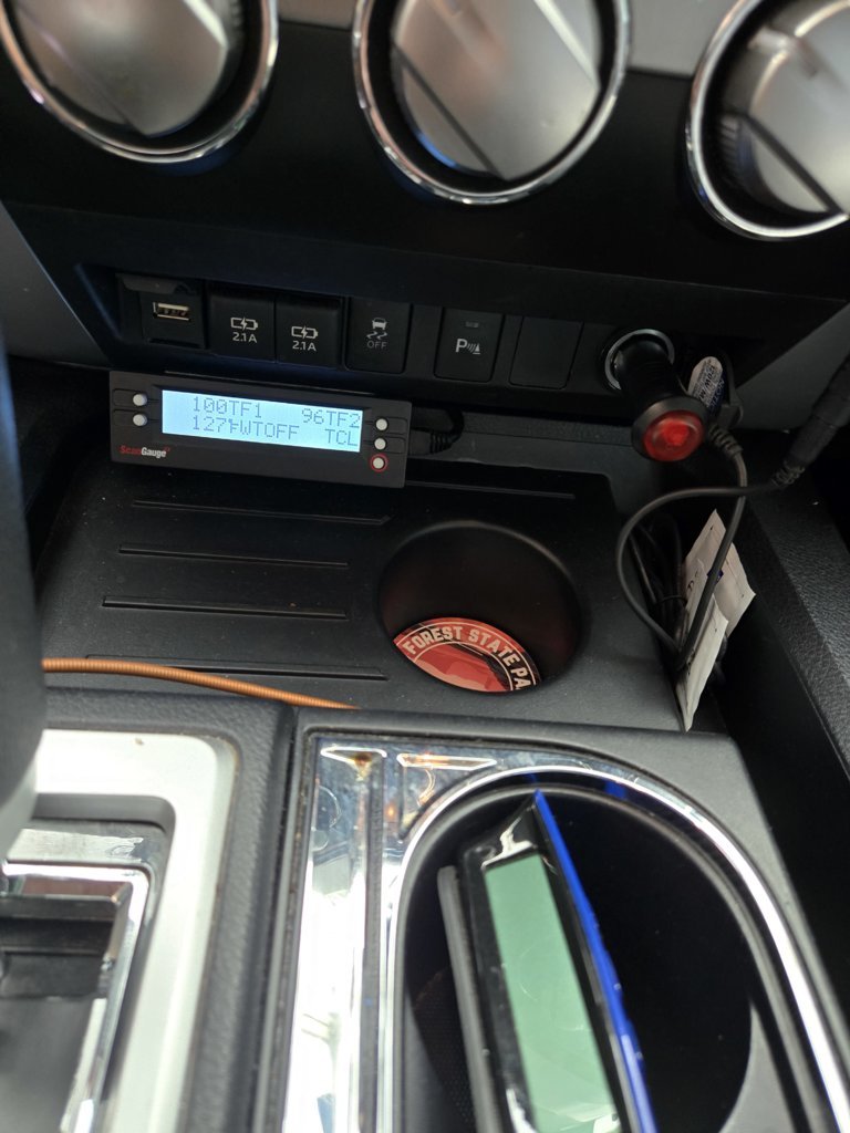

    What are using to monitor?
    Here's mine after start up and running for about 3 minutes, OAT 90 degrees.
