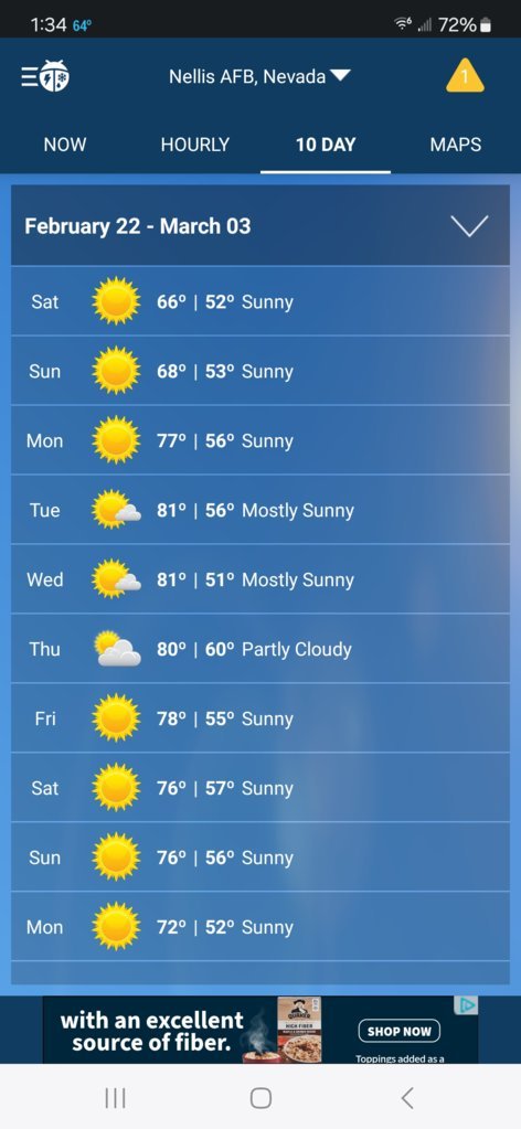

    Hahaha, you have much better weather than me! I live in the PNW, very cold right now, 38 degrees today and rainy. Cheers all!
