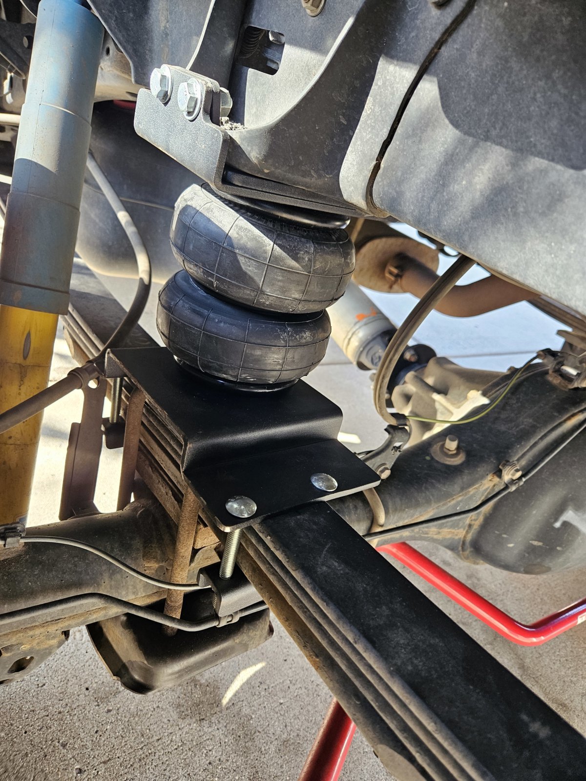

    Last week I ordered a pair of air bags and brackets for my truck. Each bag will lift 2,500 lbs. I get into some heavy tongue weights towing my '61 Cadillac Deville on my all steel car hauler, so the bags were needed.

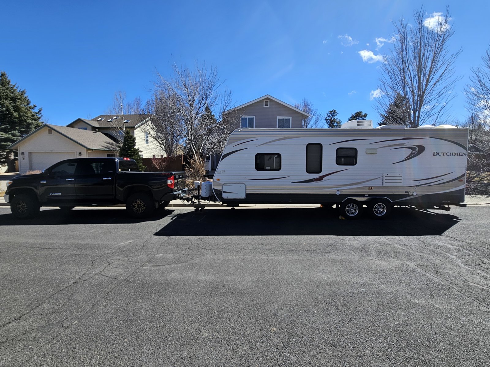

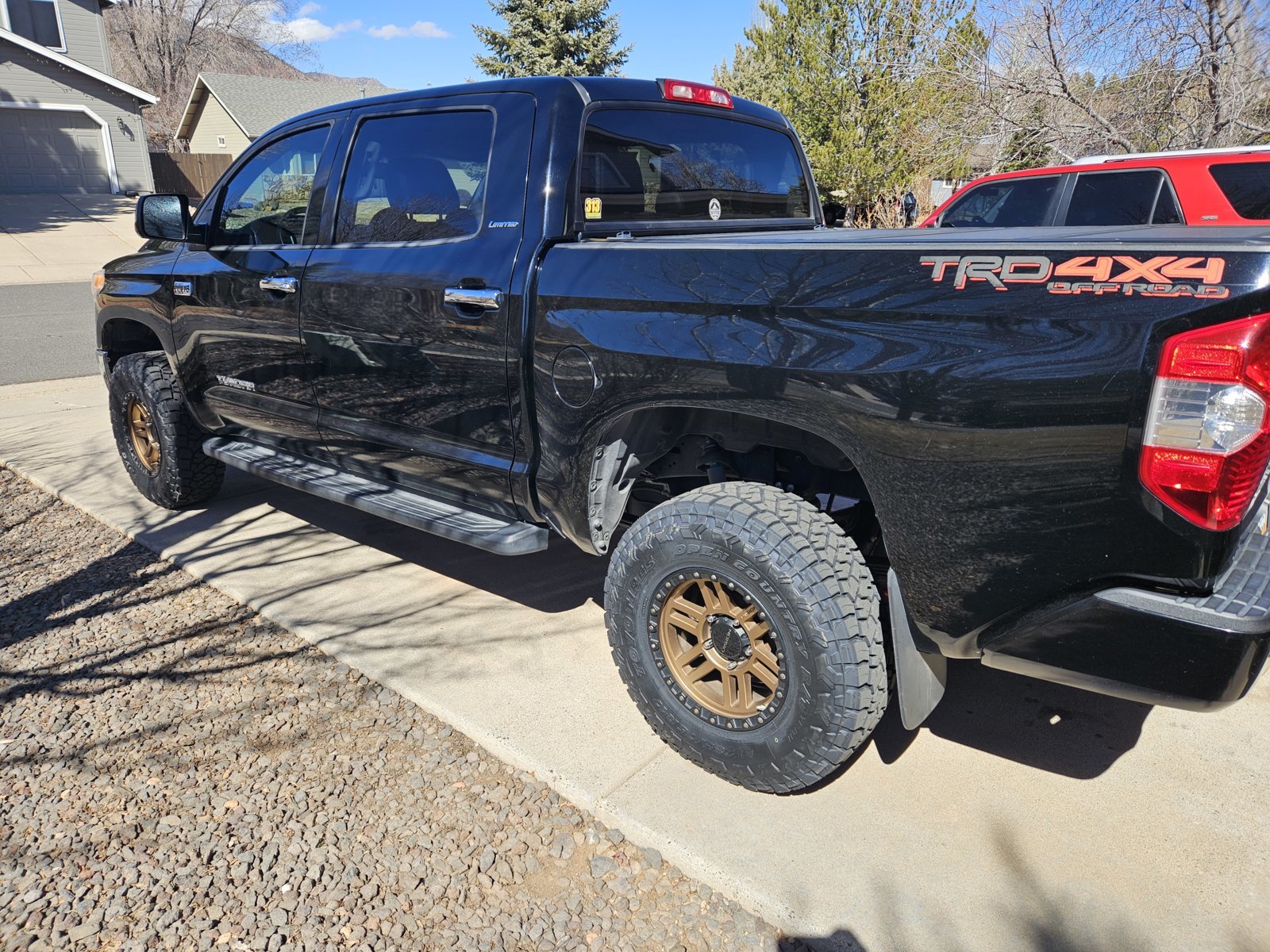

    The truck, with the new tires:
    Trailer we're dragging:
    Air bags:

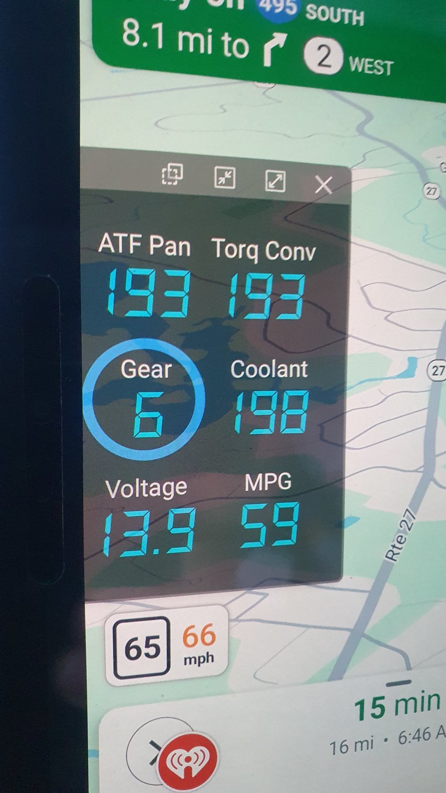

    I have the OBDlink MX+ it works right out of the box with the pan and torque converter temps, no need to add the codes manually like the cheaper OBD dongles.

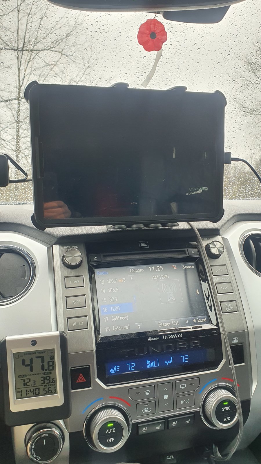

    I use it all the time. This is how i set mine up.

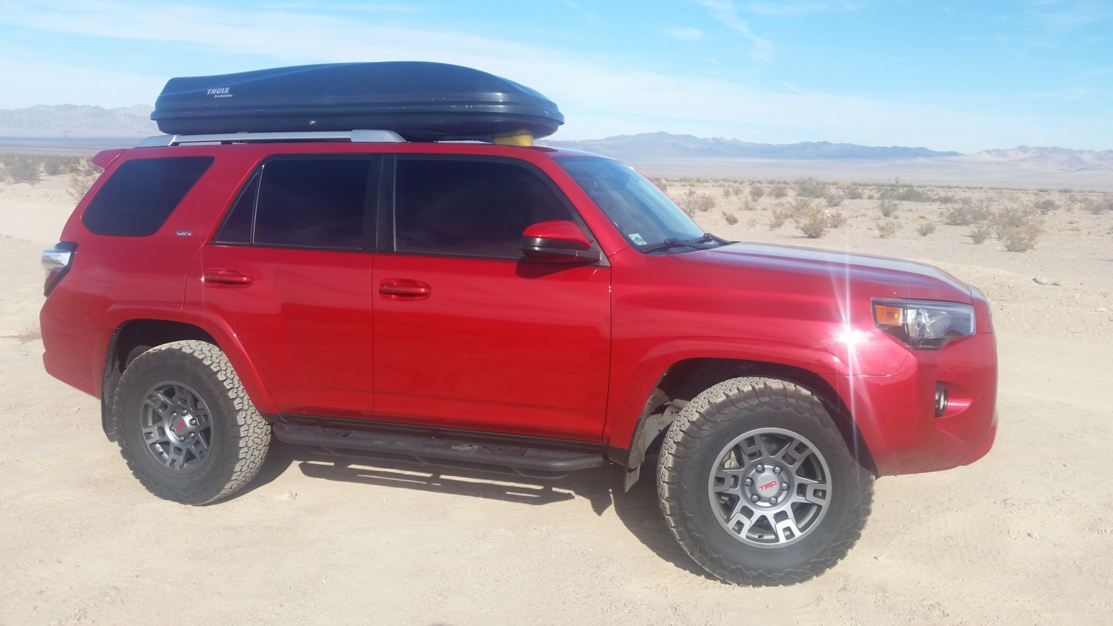

    Looks like I see a Barcelona 4R? How about some pics of the '61. :D

    Yup. My wife's T4R.

    How did you get it to display like that? Is that the factory head unit or aftermarket?

    I believe that's his phone, with a small display from the OBDLink app, displaying over a navigation app. I don't think that's the Toyota head unit.

    Ah, was hoping it was an overlay on a head unit (factory or aftermarket). I do like how that app is an overlay though.

    Its my tablet that I have mounted.
