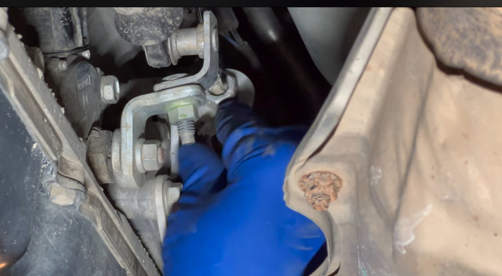

    At five minutes into the video the guy compresses a bolt and puts a pin through it. Do you know does that open or close the thermostat?

    I think that opens the thermostat.

    Like stated, pins thermostat so you get the real level of the transmission. Push in firmly with a flathead, since you want the pin to go through tje nut and pin it open.

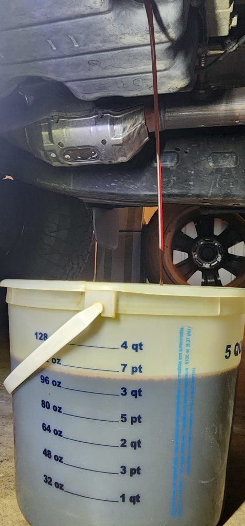

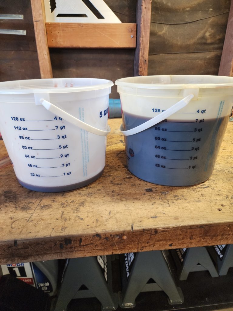

    Just did my first drain n fill on my '18 couple days ago. Did alot of research before jumping in and doing it.
    OP you 100% didn't need to drop the pan and change out the filter. That ToolDemo guy did a few things wrong in his videos. Just a simple drain n fill would've been good enough. Make sure truck is level. You would drain about 3.5qts and add 4qts. Pin the thermostat, warm to around 110° then pull the check plug till it trickles. Should drain about .5qt.
    Left one is what I drained from the check.
    Hope everything works out for you OP.
