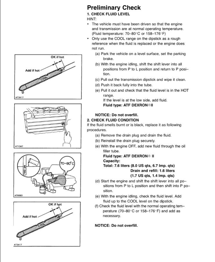

    Your 2003 should be the A340 trans. They use DexIII fluid, a drain and fill is roughly 3.5-4 qts.

    Was I dreaming about a thread where some trucks had the wrong length dipstick?

    the only thing I noticed is you never mentioned "I measured how much fluid came out and refilled the same amount"
    That's probably where things went wrong.

    Unfortunately your mechanic is right, but only half way. The system itself still holds fluid. Most of it being in the converter.
    this is possibly the reason Toyota sealed the transmissions off. And force you to go through an annoying process to get the temp/levels just right. But if it yields a transmission that can last 200k on the original fluid. I have no complaints.

    Was your truck running in Neutral while you were refilling and checking dipstick level? You might have underfilled, the trabsmission needs to "suck in" fluid while you're refilling, I found that to work better for me when checking trans fluid levels. Don't do another drain for now. Cycle through all the gears (holding brakes, obv) then keep the truck idling in Neutral, then check fluid on dipstick.
