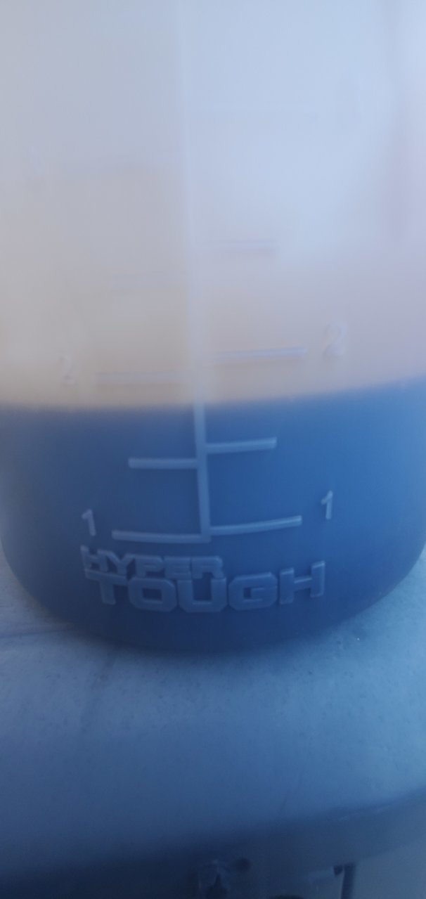

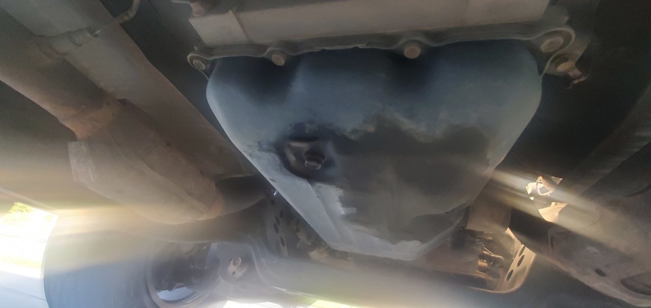

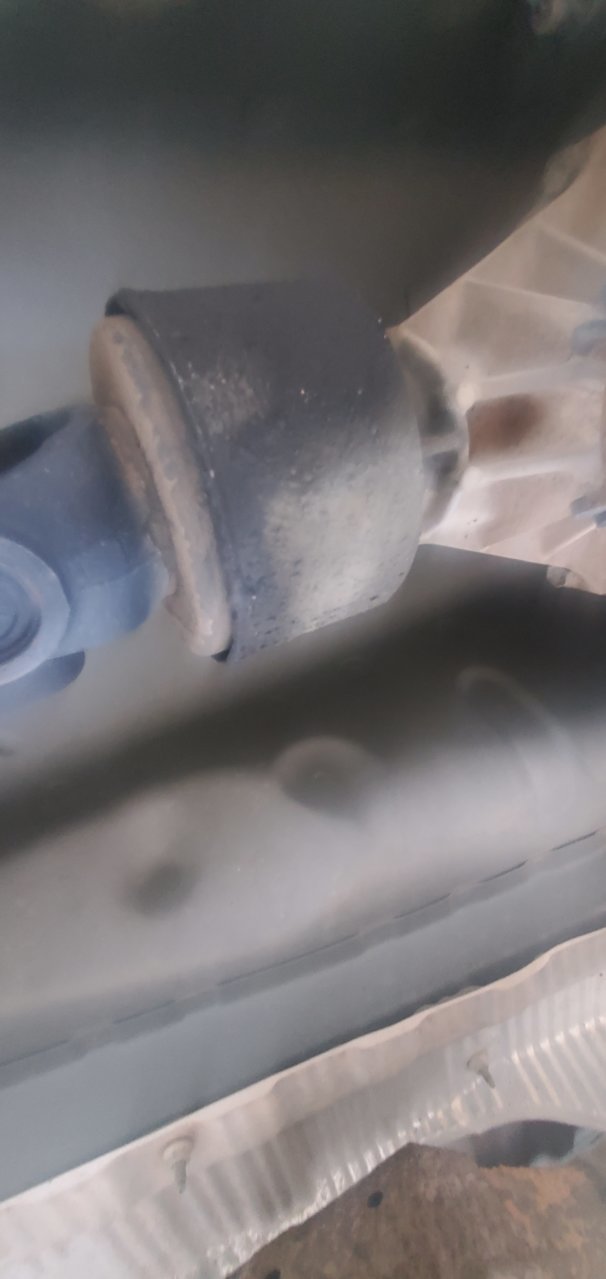

    Guys, I got seepage so truck has been bouncing when cold slow acceleration. 07 5.7L tow package 2wd 280k mi. Was told on here possibly low on fluid, can confirm at this point. I think I have 2 leaking points, the tail portion and the pan. I thought it was maybe the drain plug, but crustiness comes from the pan bolt. Drained and filled only had 2 quarts in there. Added 4.
