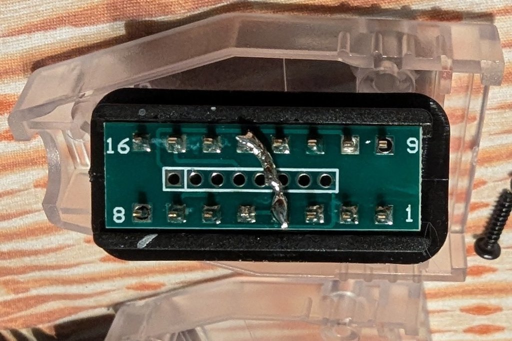

    Hello wolo. It seems strange that your OBD2 port has no pin 13. I make a jumper that looks like this, works on any OBD2 porrt.
