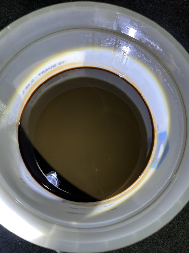

    I changed my transmission fluid over to Amsoil today. This is what my fluid looked like at 38,000 miles. I was regularly seeing 210-220 temps in the summer here in Texas, no towing just daily driving. I’m putting a cooler on sometime in the next few weeks when I have time. The photo is the second drain and fill.

    Dang. Looks like motor oil.

    Did you drain the right pan? LOL THAT SHiT IS DARK AF.

    Yeah, I’ve never had tranny fluid look that bad before. This is also with no towing.

    So that's some of the extra special lifetime fluid I've been hearing about...such bullshit...I'll be changing mine, just drain and fill, every 30k
