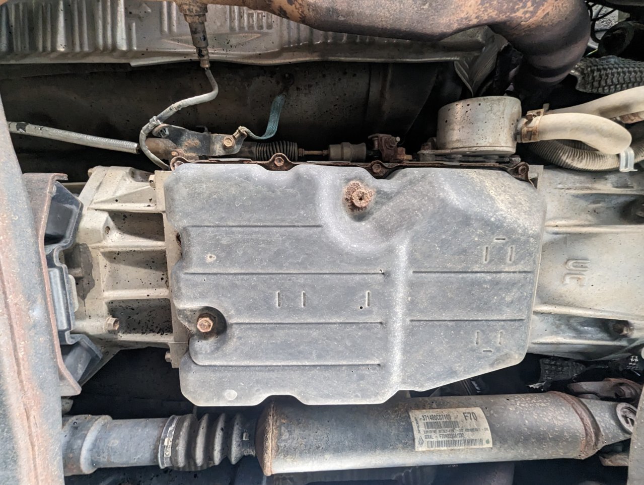

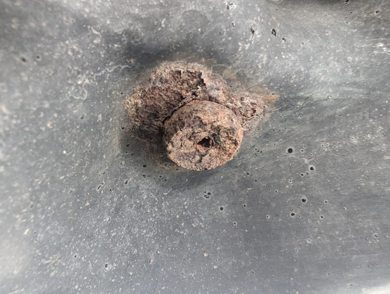

    I thought about blasting it with PB multiple times/days. Here are photos of the issue at hand. The fill plug seemed fine. The check plug has no way for me to get a solid grip on it. It even looks like it'd crumble with vice grips.
    Nice macro close up of the offending rusted check plug.

    That is quite nasty, I forgot it's straight down. Do you have a welder? Weld a nut to it.

    He'd shear most or all the 10mm pan bolts given how crusty the check plug is. Unless you're prepared to drill and heli coil the transmission case it's best to leave the pan alone.

    I'm not sure, but those bolts look sus as well. This is why I didn't want to touch it myself. Seems like something worth the $300 and change the dealer charges. If it weren't subjected to so much towing in its past life I'd leave well enough alone.

    In my experience dealers won't touch a trans over the rec service time, especially one rusted out like this one.

    First off, have you checked the fill plug. Make sure that one comes off before you do anything. The drain plug looks good and shouldn't have an issue coming off. The level check plug, the rusted out one, leave it alone. Go by the 4 quart rule. 4 quarts out, 4 quarts in. Dont over think it and dont mess with any other plugs or bolts other than the fill and drain. Get a new drain plug while you are at it.

    Some of those pan bolts look pretty rusted also. I’d be concerned of rust eating through the pan and bolts. I’d consider replacing the pan and bolts. Replace ATF filter while you are at it.

    worst case that bolt breaks all the threads out. You can just weld it back in shut tight like it was before right?

    +1, I have done drain and fills on Tacomas and Tundra. That is what I do. You want the temp of the fluid you drain to be the same as what you put in. Does it really matter? Maybe not.

    Not enough....
    I know that's the train of thought with a lot of folks, but it's a sacrificial fluid. It's meant to be changed out. At your mileage yeah I wouldn't flush it. I did a full flush at around 90k miles and it was fine, but the fluid also didn't look that bad.
    There has been way too much concern over a single bolt honestly lol. A good tech can get that out with vice grips in 30 seconds. Like I said, find a local mechanic that has a good reputation and just do a simple drain and fill. You'll be just fine. Or do the drain and refill with the equal amount that came out (approx 4 quarts). I saw your other post and that truck looks good (rust wise) for the mileage. That's good the frame has been treated with fluid film before. If you're interested, look up Krown undercoating. It's a similar product but it's a more comprehensive treatment. It's fairly cheap and quite effective. I live in PA and it's been holding up great for over 4 years with yearly treatments.
    drpheta[QUOTED][OP] likes this.
